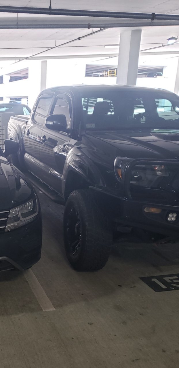

    Alright guys! I need some input here.
    It's time to upgrade out of my busted toytecs. I'm leaning heavily to some Fox 2.5s, for the 3" lift factor. I think the Fox 2.0s could work, but I've got and ARB bumper, Apex sliders, aspirations for a winch soon, so weight is my only concern. With the 2.0s only advertising 2" of list, also a reason why I'm leaning towards the 2.5s.
    I'm finding pairs of 2.5s for 1,400 bucks give or take, curious if anyone has a better deal!
    I do a little bit of hauling for work, but the toy AAL is doing well for that for the time being.
    Thanks in advance guys!

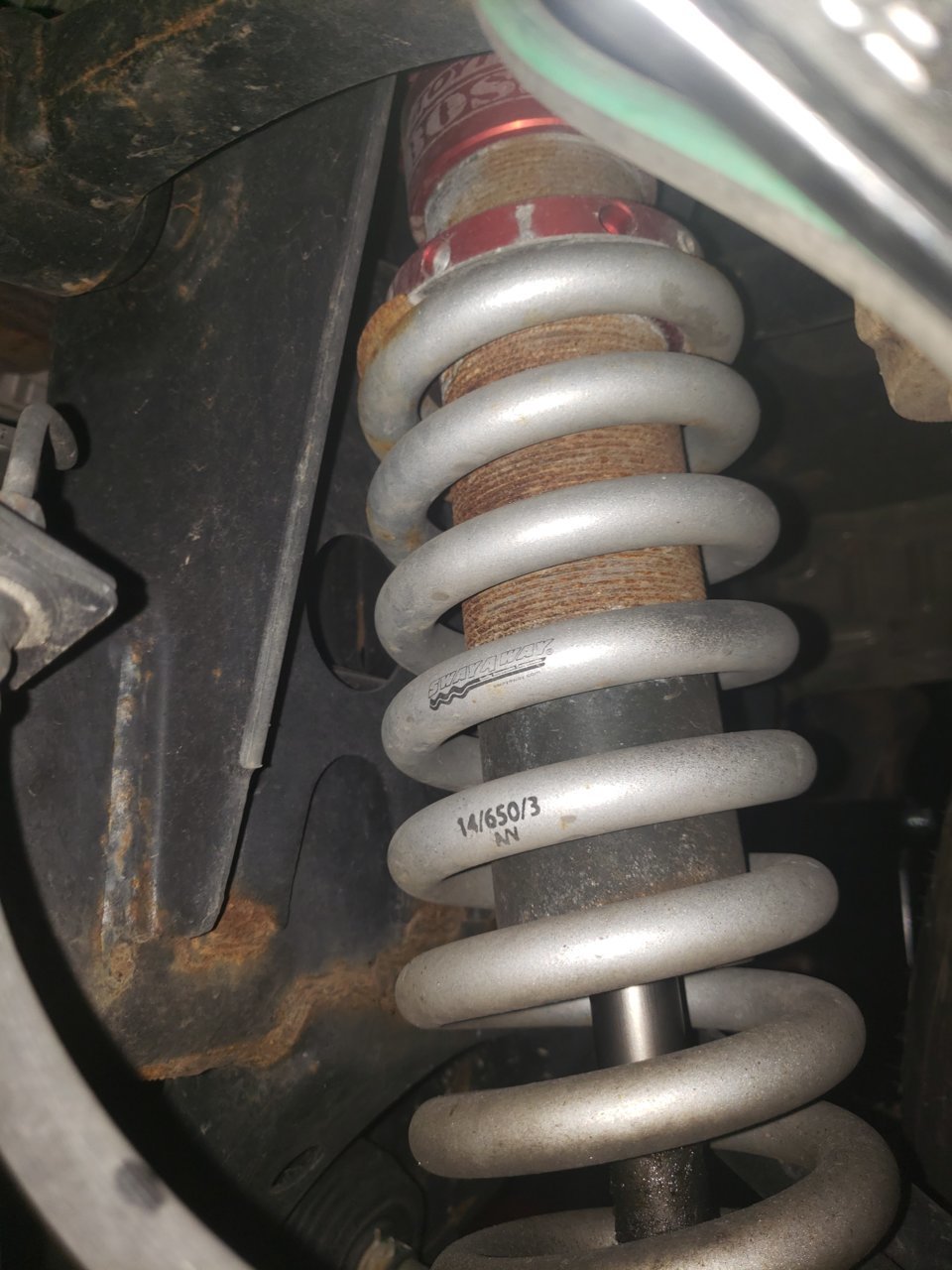

    I've got some sway a ways #650 on the toytecs now, was thinking about bringing them over

    If I recall, the Bilstein 5100/toytec combo utilizes a completely different spring type. You will need a spring made for 2.5" coilovers. The difference is that the springs on the 5100 are tapered whilst the 2.5" springs are straight with no taper.

    I don't have the 5100s I've got the Boss aluma series

    Ah gotcha, as some members have stated, you should be good. I misunderstood your existing setup. Let us know how it goes.
