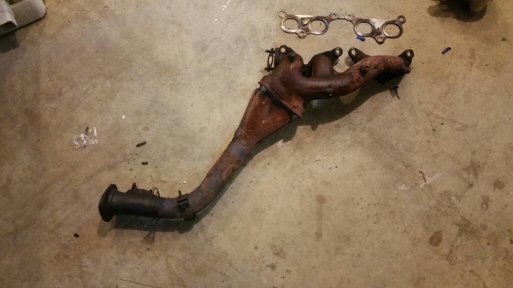

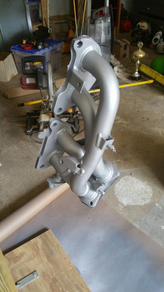

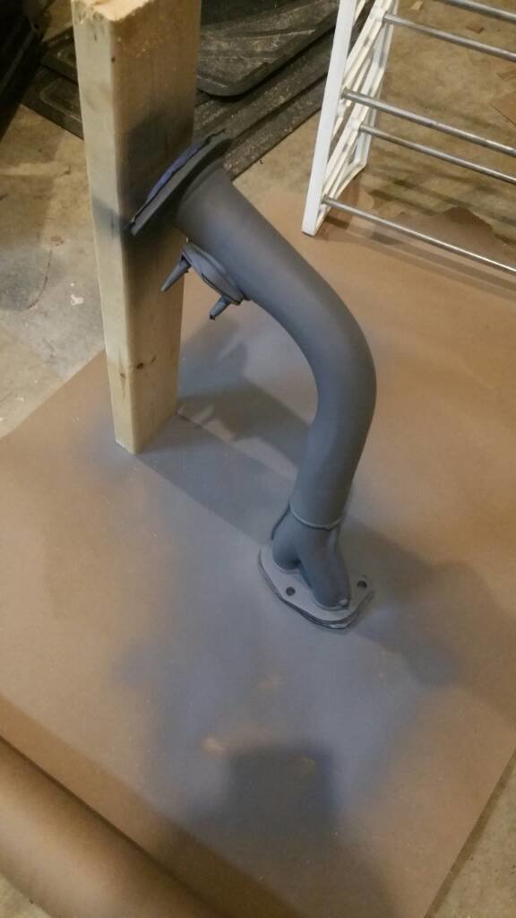

    fc812d546d05f49992435b9a8119d8e8_79ca7d91dd3f4abb42a5f6a0ed9b36ae5a58bc46.jpg3a3613b3553abe538ba6ccb17fe0ce6e_26166376c55e1b0338488e60d57ada07a13256c7.jpg11a3fc76b02ff2026250ef19ede3fa1c_708dba9b8aab343c683888a6e490e4378d1f6fc9.jpg
    Out with the old. Got the old one out without too much trouble. Got the new headers and down pipe ready to go. I have all new felpro gaskets but I have a question: should I use additional copper rtv to make the seal or stick with just the gaskets? Aslo, check out the wire ties that were being used to hold the oxygen sensor down put on by the PO. That couldn't have been helping anything.

    what paint did you use?
  11. May 19, 2016 at 12:12 PM
    SOMDTACO
    SOMDTACO Well-Known Member
    Feb 20, 2012
    #73195
    207
    Sean
    Southern Maryland
    96 Extended Cab 4x4 2.7 MT
    New Taco: 96 DLX Extended Cab 4x4 2.7,MT, Bilstein 5100s at 2.5 and HS 3 Leaf AAL Old Taco: 11 Prerunner Maxtrac Spindles in the front, 2'' AAL with Bilstein 5100 extended in the back. 18'' Milanni Stellars wrapped in 265/70/18 General Grabber tires.
    I used the Rustoleum Automotive high Heat 2000* paint and primer. Paint color was flat aluminum. We'll see how it holds up. I'm going to ghetto bake it by starting the truck up, idling for a few minutes, then letting it cool off a few times. No way my wife would let me put it in the oven haha.
