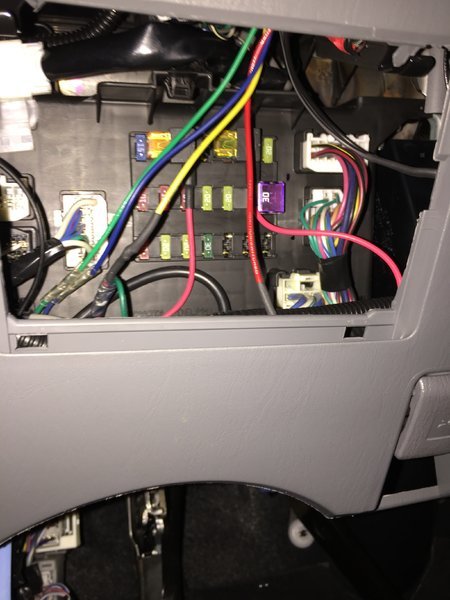

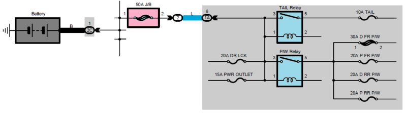

    15 Amp Pwr Outlet is another choice...for later. And if you need more power inside cab, remember the power window circuit....

    This... I use ACC fuse for power when key is in on or truck running, or power outlet fuse for constant 12v

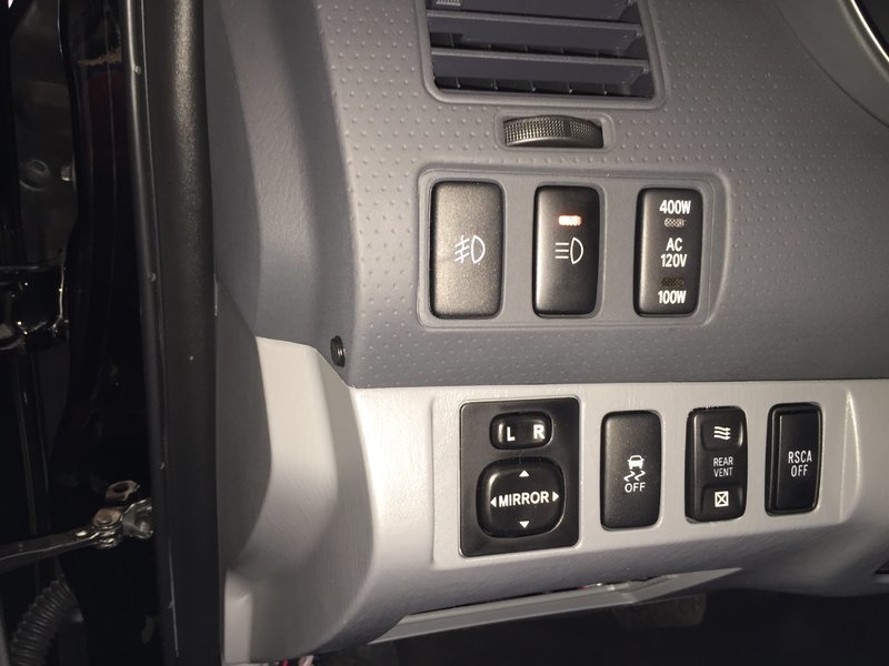

    I have my tailgate lock and bed lights off of PWR OUTLET 15A
    My switch lighting is off of TAIL 10A
