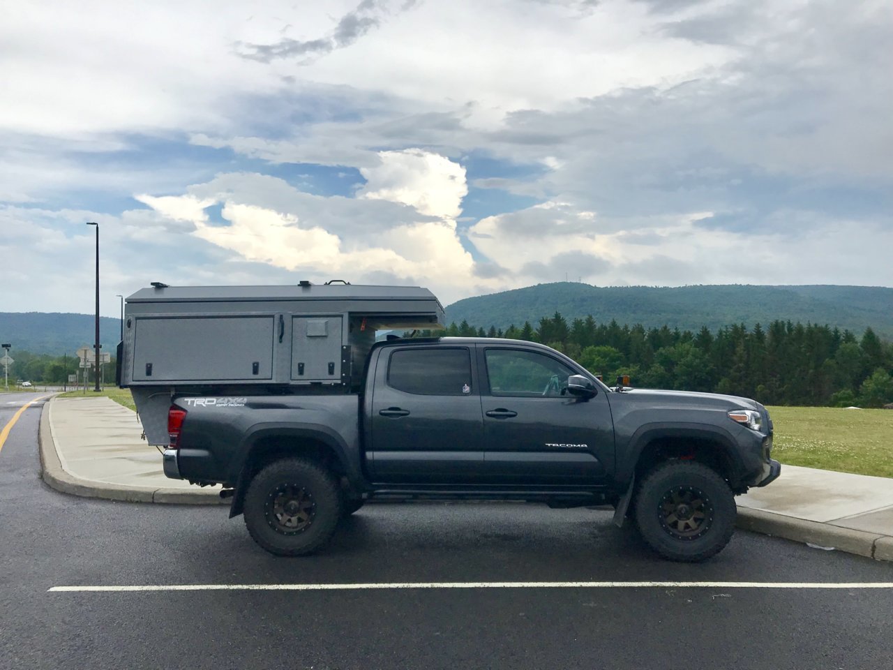

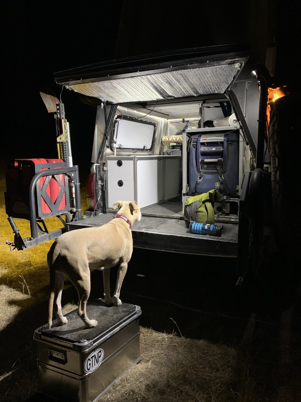

    If you’ve got the cash Goose Gear makes a pretty complete setup for the drifter (in addition to a rear seat delete for you as well)
    078FF675-9ACA-432A-8566-DEB20E0C2390.jpg 0CD4B188-3747-4F9E-BD5D-1D88E107C8ED.jpg
    I’ve actually changed my setup drastically since this thread. Not very stealth but I have ALL the amenities of an RV now and man is it comfortable and convenient. I know there’s a lot of happy Drifter owners out there, including a Mega-Thread on drifter builds if you search...

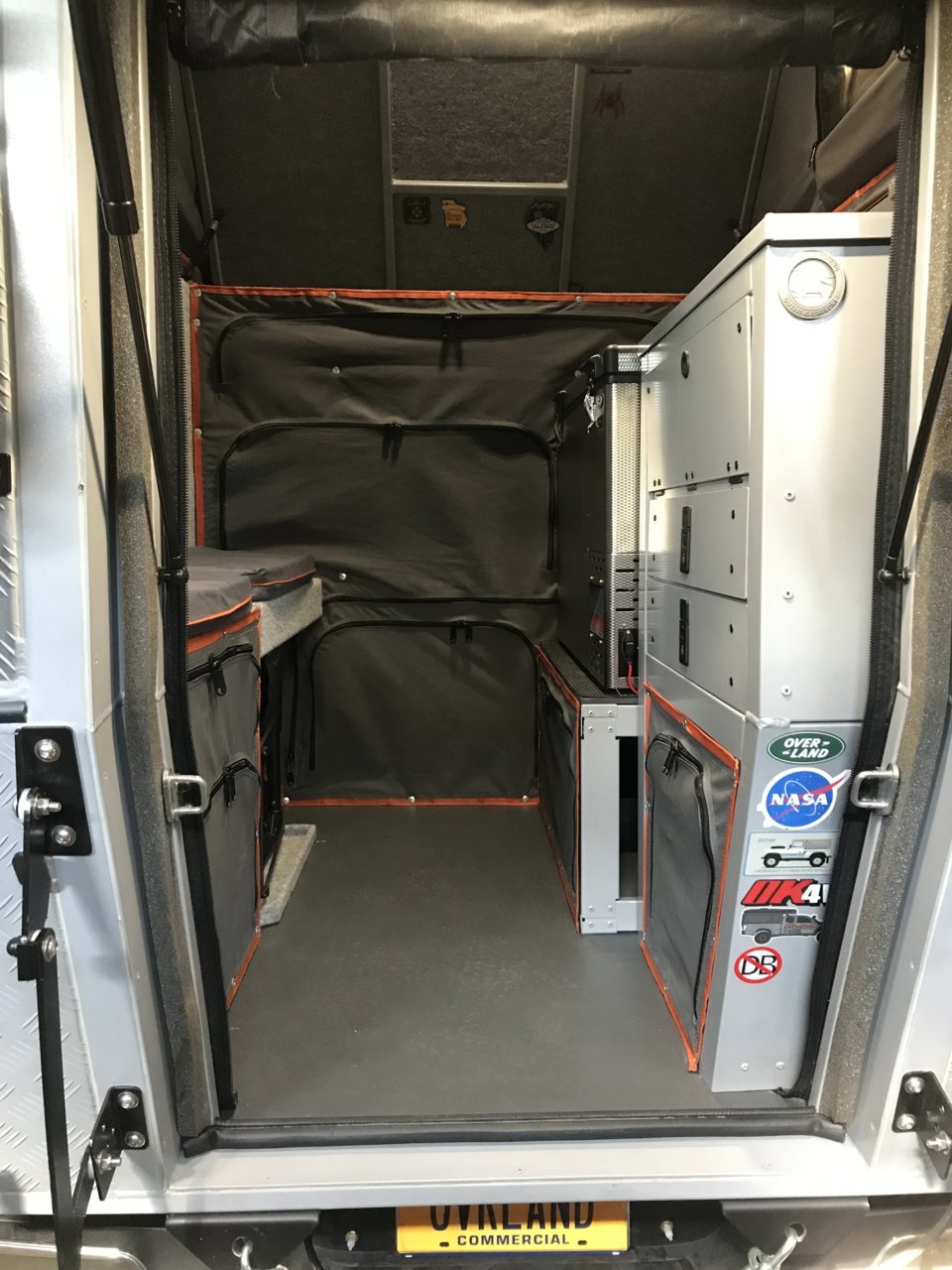

    View from the back hatch in. Zippered storage everywhere because it’s lighter in weight and thinner. You can just see two front runner chairs tucked up in there on the bottom left.

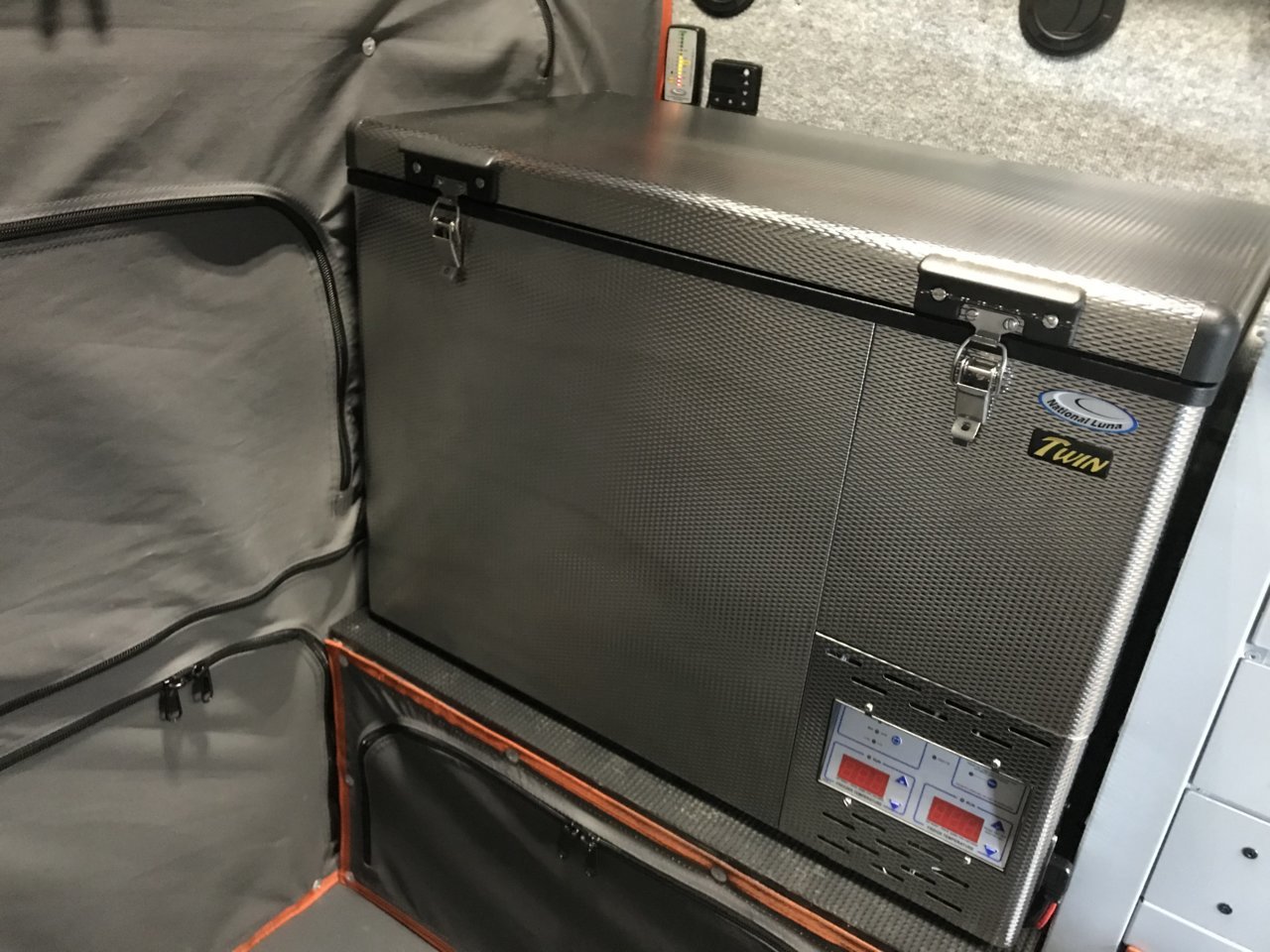

    National Luna dual zone fridge... been amazed by this I also have (from my previous build) an ARB 63 that was great but this dual zone is something else.

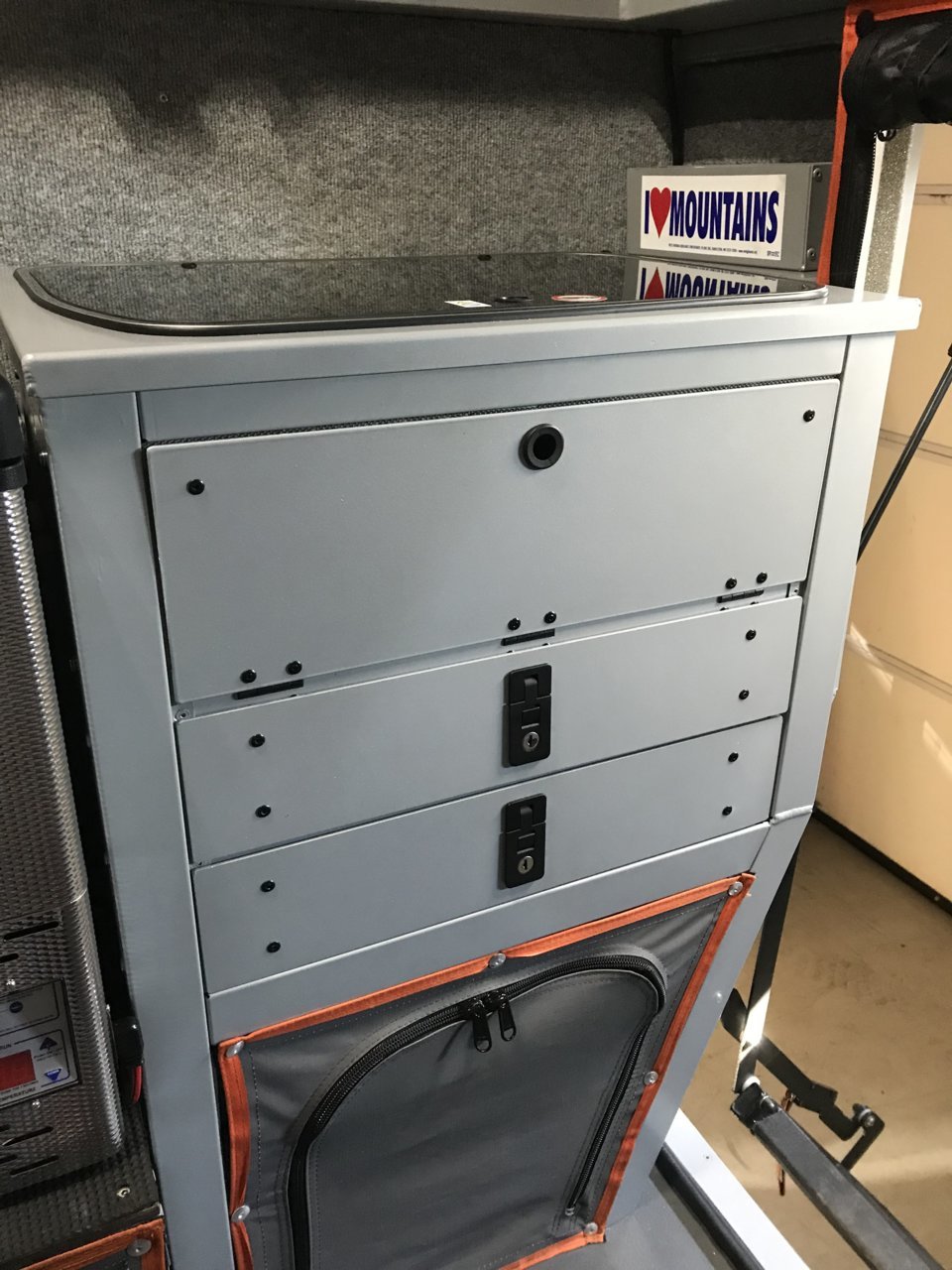

    Cabinets are all made from aluminum with marine grade latches.

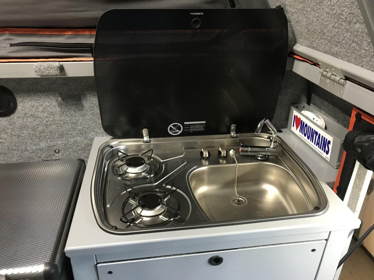

    Dometic sink and stove combo.

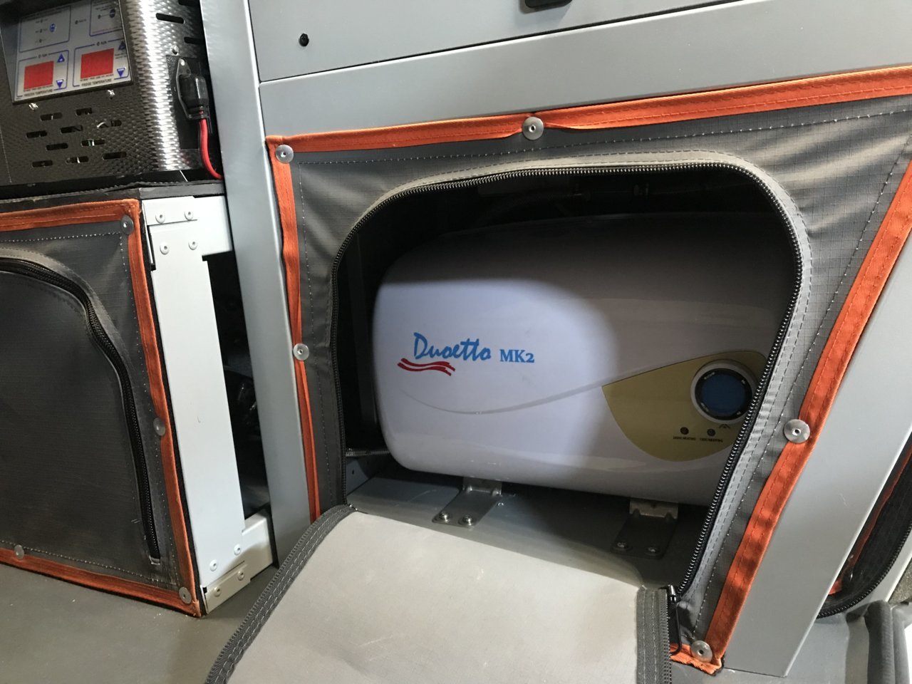

    Duetto 12V, 1 Gallon water heater with mixing valve provides water to outdoor shower.

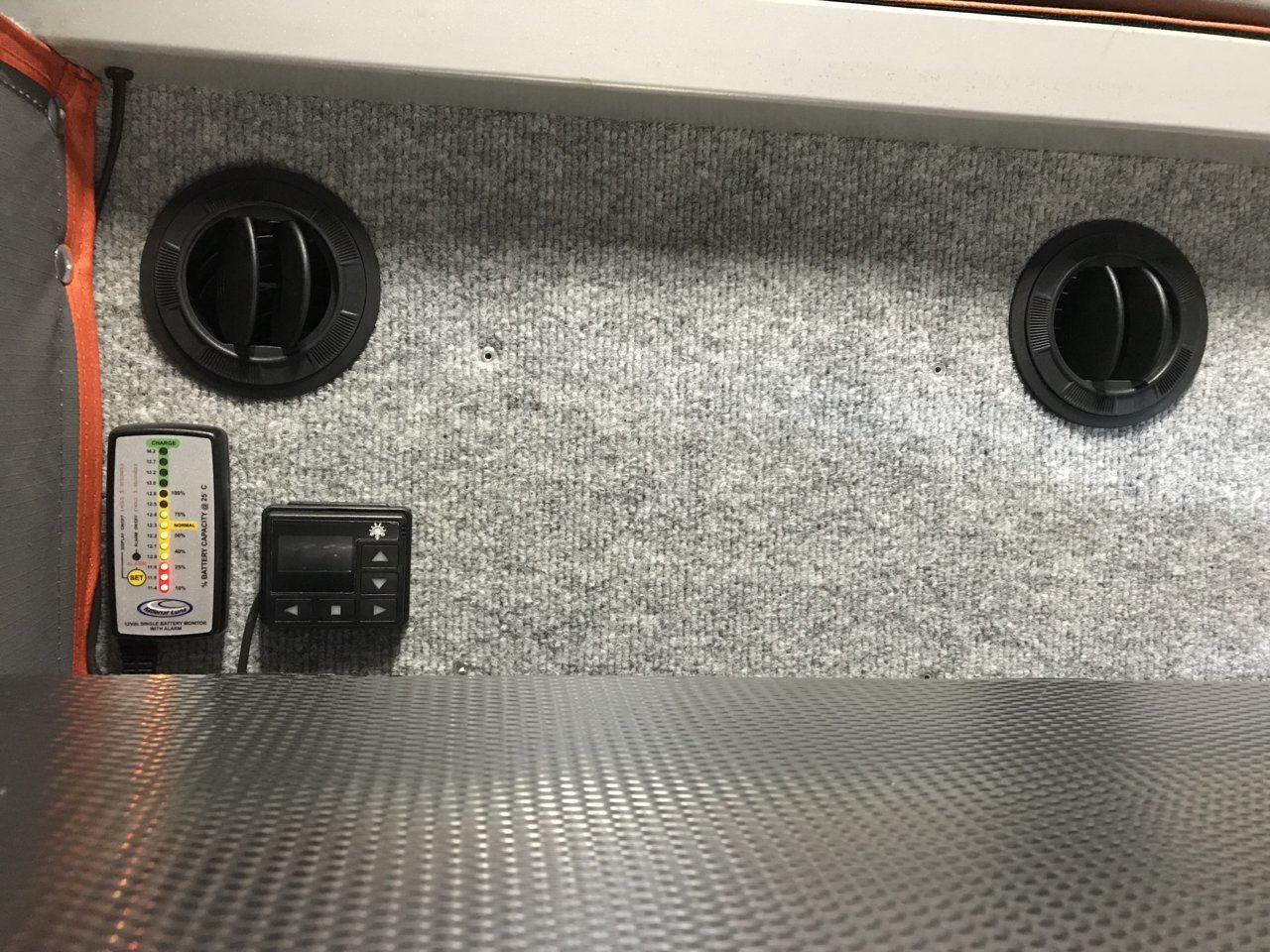

    This is the Supply and Return air for the Diesel Planar heater. All outside combustion so nothing but warm DRY, clean air. National Luna Battery monitor for the house battery.

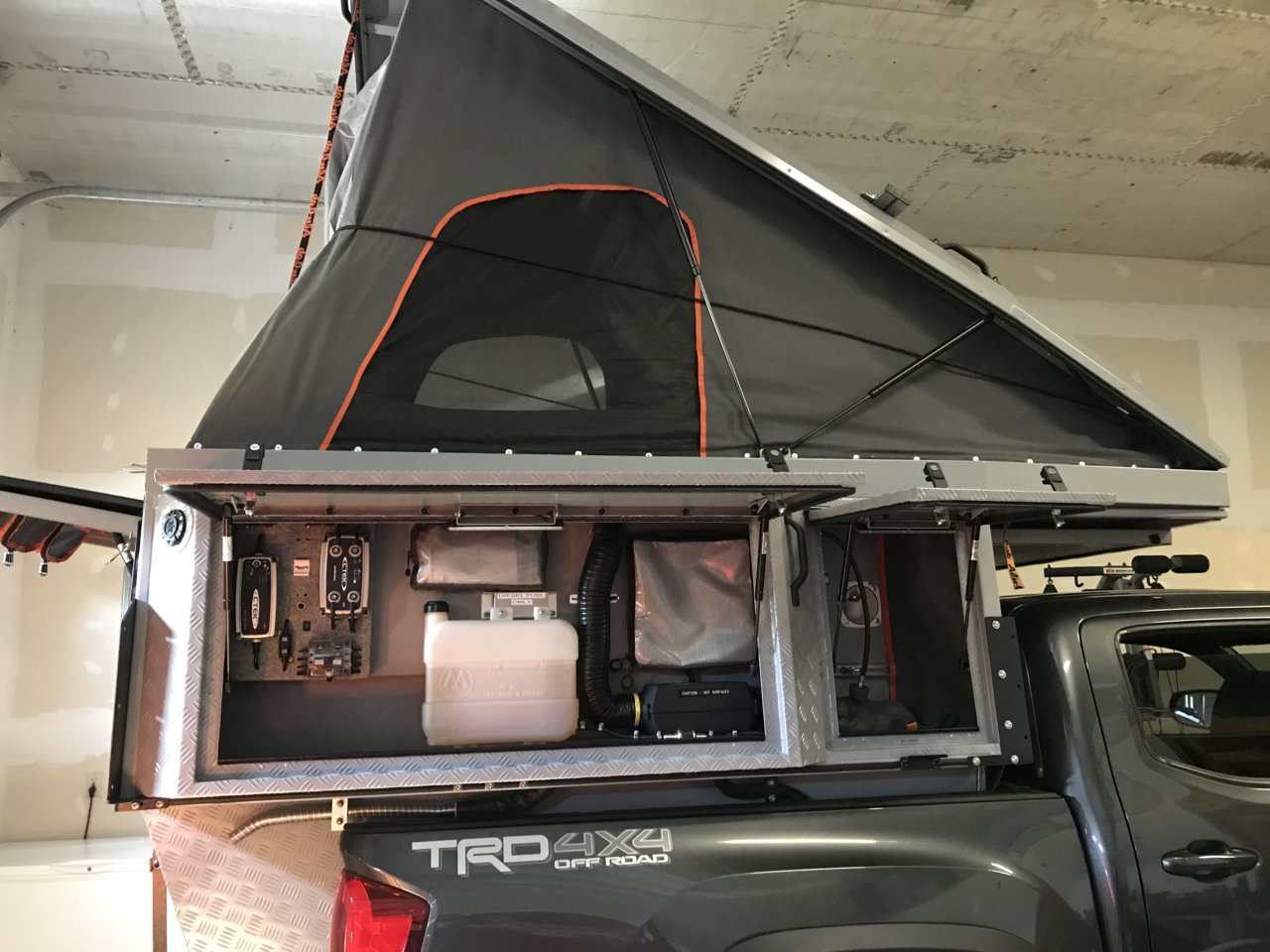

    “Utilities Cabinet” this houses all the trucks utilities. C-Tek charging systems for DC/DC as well as 200W solar on the roof, Diesel heater with separate tank and some extra storage. Compartment to the right houses the shower and 5lb propane bottle to run the indoor stove.

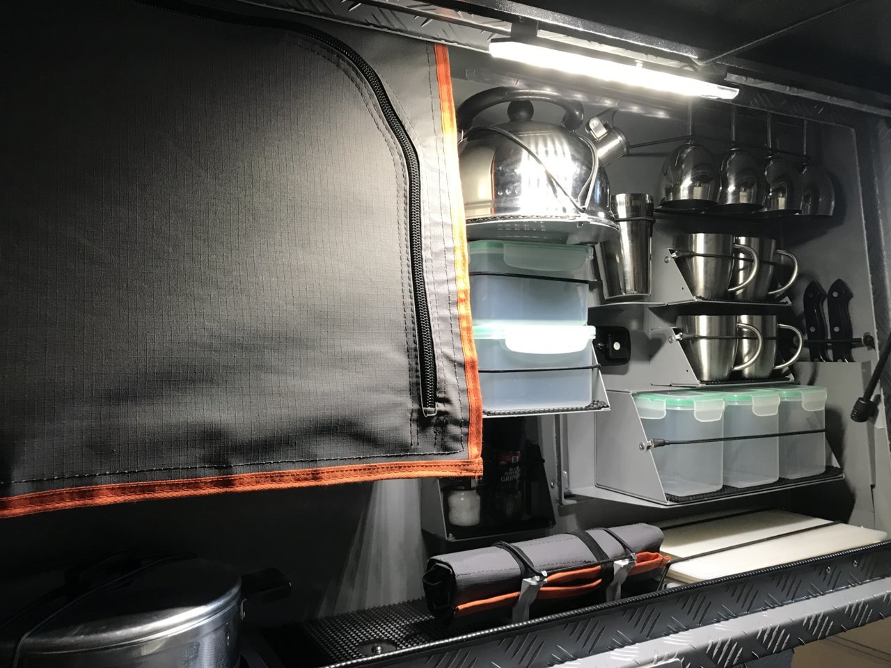

    Kitchen... place settings for 4, the little coffee nook type thing in the upper right corner swings inside the camper so you don’t need to get outside in the weather to make your coffee... Priorities!

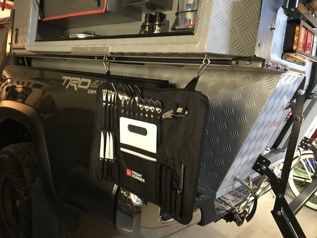

    One of my late additions. Front Runner flatware kit.

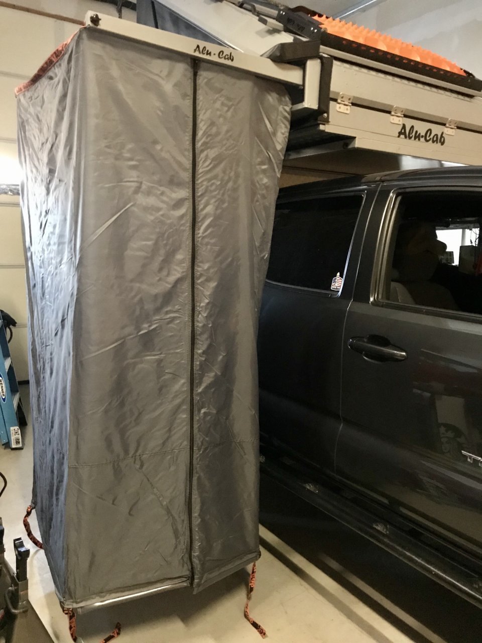

    Just added this as well. It’s an Alu Cab Privacy enclosure, twice as big as what came with the unit and sets up in 15 seconds. This is used for showers (rarely) or as a bathroom with our Wrappon Green Toilet.
    And obviously the privacy shelter folded out. Goes back in almost as fast I HIGHLY recommend one of these. After owning an ARB awning and struggling to set it up solo, this and the Alu Cab Shadow on the other side are simply amazing.

    Hey I’m sorry for the delay, I’m guessing this question was for me but since I wasn’t quoted I didn’t get an alert about it, anyway....
    The duoetto HW heater is 10L or about 2.5 US Gallons. And yes it’s 12V powered. As mentioned above you need to pull over about 30-60 mins out from your destination and flip on a switch to heat up the tank of water. Once you arrive the hot water and the onboard tank I have (22 US Gallons) are combined via a mixing valve, just like your shower at home and provide you with a comfortable shower. Works GREAT that said it must be used sparingly as with any camper system when boondocking. When we camp it’s only used to rinse down quickly and occasionally, it’s usually much easier to find a shower every 4 or 5 days and clean yourself up normally another way.
    Bottom line is it works amazing but you need to understand the limits of the system 22 gallons of fresh and 2.5 gallons of HW isn’t going to let you live like you’re in an apartment and water is HEAVY.
    https://m.youtube.com/watch?v=P_y9wIEl018
    This actually isn’t the exact video I was looking for on it but this is ASPW giving his opinion of the Duoetto heater, basically it’s what he uses and he’s tried everything. There’s a Video out there somewhere showing it in his LC with a portable tank he uses to mix if I can find it I’ll repost it for you to watch.
    Anyway long story short it’s amazing and works very well, however it’s not a deal breaker to hit a KOA every once and a while either, in fact we normally stay somewhere like that about once a week or so just to catch up on laundry and relax and have a long warm shower.
    Good luck with your build but be mindful of water storage. The weight will hurt more than you think!
