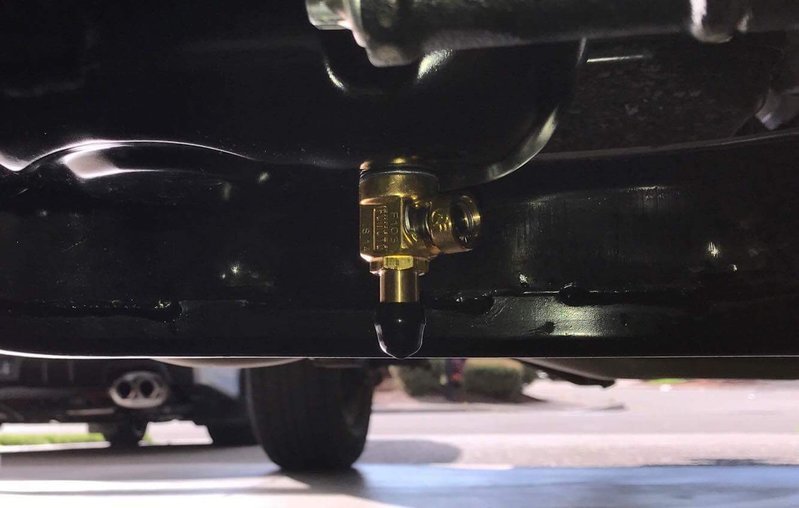

  14. May 15, 2017 at 4:52 PM

    I installed mine last weekend. It should be a lot cleaner now. My RCI skid plate is off in the picture but with it on nothing protrudes below the skid plate.
  15. May 15, 2017 at 5:39 PM

    How close to the skid is the valve? I was thinking if it might work so I don't have to drop the skid to change oil

    It's close. I think I will be about to attach a hose to the nipple and open the valve without dropping the plate. I haven't tried to open the valve yet but it feels like I will have no problems now.
