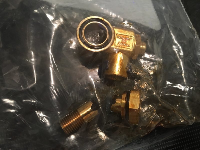

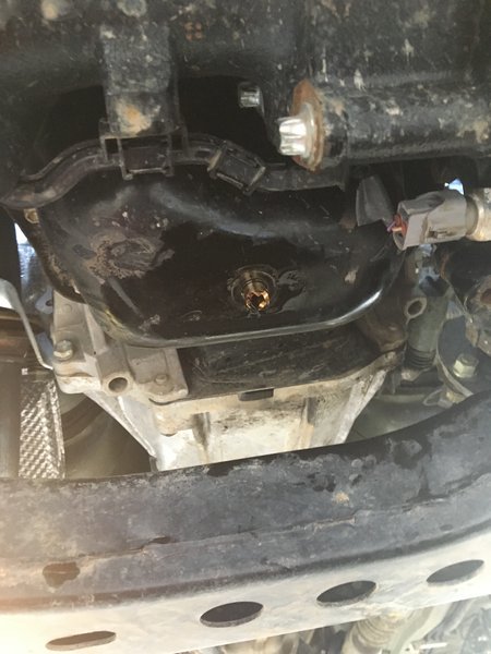

    Why yes, that is a Fumoto 103SX ... snapped off in my oil pan.
    See those two bits on the bottom? Those should be one bit >_< (and yes, I double checked the torque of 15 ft lbs on their website)
    Guess I get to see how good their warranty department is.

    Snapped from overtorque or snapped from other causes?

    From installation torque of 15 ft lbs. installed it, didn't like the orientation, loosened it to reorient the drain, and when I got close to the specified torque again it snapped.
