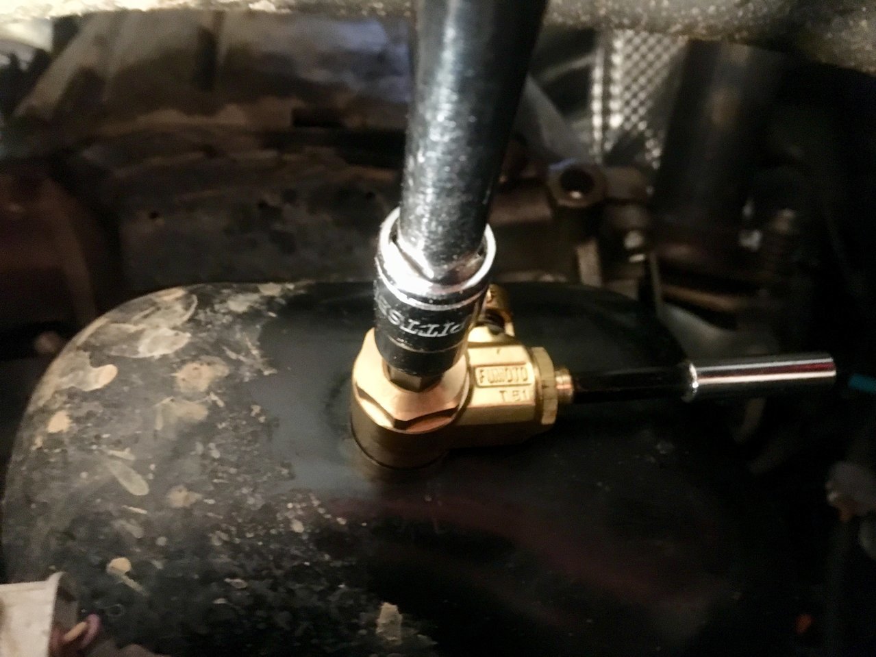

    Update the second - finally got a chance to try a second install of the Fumoto. This time I skipped the torque wrench and went with ‘snug’ (didn’t trust either of my torque wrenches at this range without calibration since the one that’s good for this range is the one I used above). Also, figured out that on the sx valve, a 1/4” hex extension fits the drain hole perfectly, allowing me to control the orientation a lot easier.
    Sorry for the poor quality photo, took it on my back, looking slightly towards the back of the truck, you can see the 1/4” extension out the right side of the valve.
    After the install, took the truck for a 2000 mile trip from CO->NM->AZ->UT->CO, camping off of forest service roads every night. Happy to report no leaks, and the clip is still in place!
