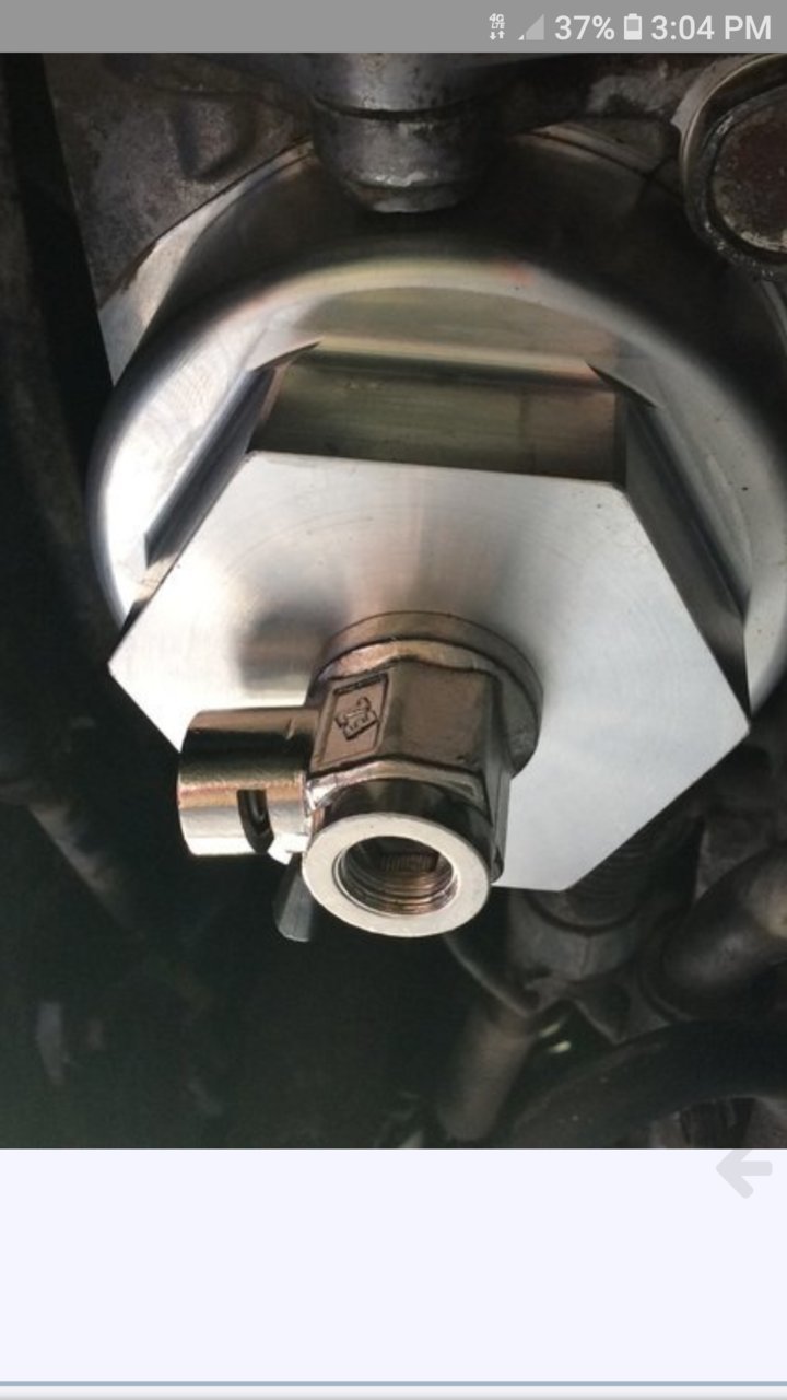

    I have this cartridge in wife's Lexus and there should be no mess if you do it right ... remove filter housing drain bolt; drain the oil; put the bolt back in; remove housing; remove oil filter and drain remaining oil from the housing. I'm assuming the housing faces down in the 3rd Gen Taco as it does in the Lexus; if not, it will make a mess.
    I had a Fumoto valve on the Lexus but it hung too low and got paranoid it was going to catch on road debris; so, removed it. Works great on the Taco though because a cross member provides protection.

    I used a stalhbus drain valve on mine. Much lower profile, German made and unique. Loving it so far.
