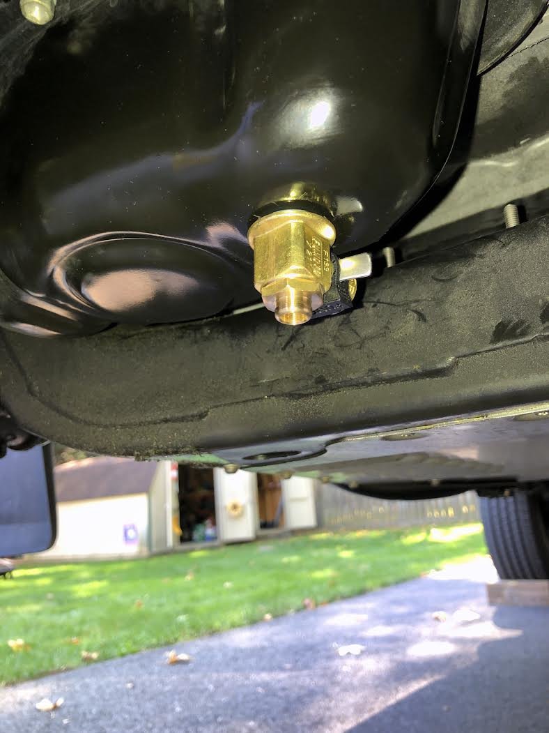

    I’m still a ways from my first oil change with the new fumoto installed.
    Kind of wishing I got the short nipple to add a hose to it.
    I was wondering about not having the drain plug magnet anymore and if that’ll be an issue over time. It always seemed to have some stuff to clean off, and now that’s not possible.
    Worst case I can stick a strong magnet on the pan near the valve to at least hold stuff there.

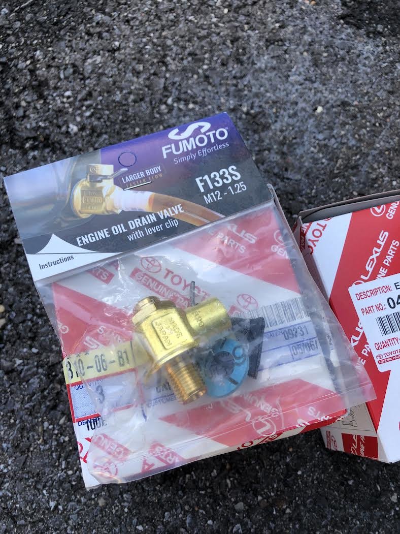

    This is the valve I got from Amazon, its been in my 2019 Off Road for 3 years with no problem and works great.
