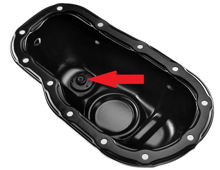

    I think I saw someone mention this somewhere but, that valve sticks up through the pan nearly a 1/4 inch which means you have that much dirty oil still in the pan after draining the valve, as compared to the plug which allows you to get every last drop out. And I want all that guck out
  19. Jun 26, 2023 at 8:33 AM
    #79
    Jimmyh
    Jimmyh Well-Known Member
    May 16, 2012
    #78991
    14,321
    SC
    2012 Prerunner SR5
    Well the design of the pan doesn't allow you to get it all out either. Look at the image below and you will see it also has about a quarter inch lip inside the threaded insert for the drain plug. And add to that the oil in the dimple for the pickup strainer...
