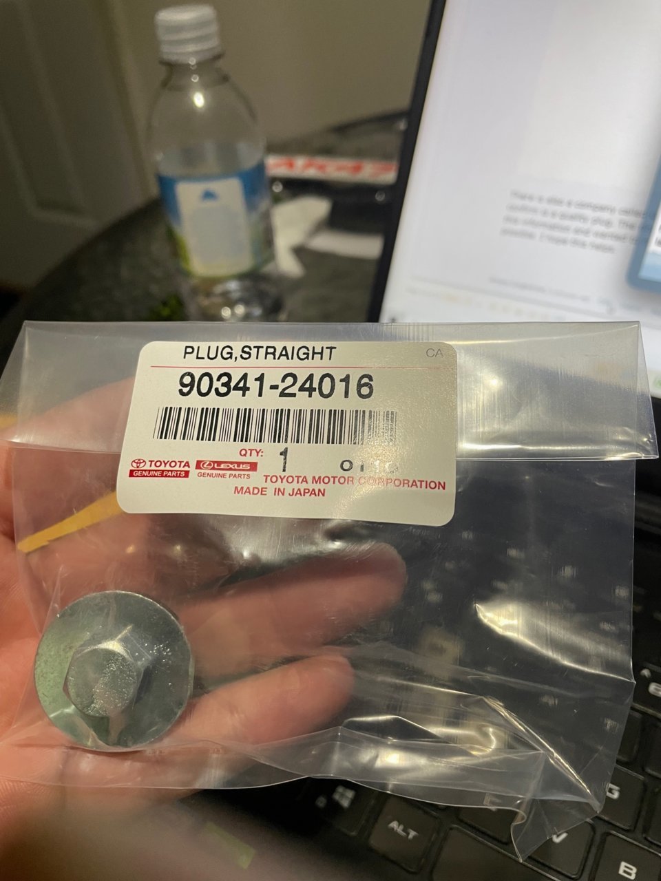

    Votex is the only maker of stainless steel neodymium plugs for all our powertrain components except the front diff drain plug that I know of. Gold Plugs is another maker, but I haven't confirmed fitment of theirs other than for the engine oil.
    So basically every fill and drain, front diff, transfer case, manual transmission, and rear differential is an M18x1.5 thread pattern except one, the exception being the front differential drain plug, which is an M24x1.5. They had to make one different, larger in diameter, but retain the same 10mm allen plug to challenge you. I believe the automatic transmission uses at least 2 of the 3 plugs in M18x1.5 in the fill and check, but I am not totally sure about the drain. Both the automatic and manual transmission has internal magnets as well, but I add magnets wherever fluids/oils exists if possible. Anyway, here are the M18x1.5 Toyota factory plugs that are compatible.
    90341-18021 is the round one with the 10mm Allen and short magnet.
    90341-18057 is 24mm hex head with a short magnet.
    90341-18040 is 24mm hex head with a tall magnet.
    90341-18035 is the 10mm Allen key with a tall magnet.
    90341-18044 from the old 90's twin turbo Supra. Jowett, a member here posted all of this stuff in a different thread and I emailed the information to myself. However, none of these factory plugs are neodymium.
    Edit to add Lexus Part # 90341-24016 in M24x1.5 specifically for the front differential drain and is a short magnet. This plug is easier to work with than the existing 10mm and is probably the best option for replacement at this time of the 10mm which seems to strip so easily for everyone.
    Since Dimple is not looking good for me, there is another maker called Votex, which makes an 18x1.5 plug compatible with our trucks, the only stainless steel neodymium plugs I know of. I explained to Zach at Votex (an owner/operator) how the front diff plug is the bane of Tacoma front diff existence and it looks like he is pretty good with communication, and is set to make one available in the next few months.
    Anyway, the Votex part number for our M18x1.5 is: DP007
    There is also a company called Gold Plug but I am not sure if they fit except for the engine oil pan. I am in the process of finding out. Votex does fit however and I can confirm is a quality plug. The ring of the plug where the gasket sits is a tiny bit smaller than OEM but I don't have any issues with factory gaskets. I was putting together this information and wanted to make one thread as resource material for other nerds who want to keep as much metal out of their unfiltered powertrain components as possible.
    Also I can only confirm fitment of the two factory M18x1.5 long and the one factory extra long Supra magnet in the manual transmission drain and rear differential drain at this time. The neodymiums are closer to the short than long magnets and will fit anywhere. I hope this helps.

    Thanks for sharing! Keep us posted. I’d love to change-over my diffs, transfer, and transmission over to these types of plugs.
  20. Oct 16, 2021 at 5:52 AM
