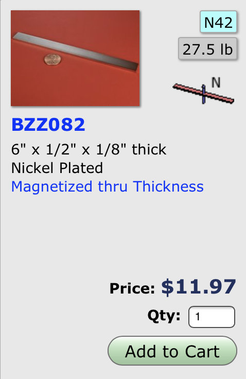

    Here’s one more thought, something I am going to to move forward on now. I’m going to purchase one of these neodymium magnets in a large size and use it in the monthly oil I drain out and bypass filter. OR
    1. Drain oil out of your engine using a Fumoto valve directly into a clean jug.
    2. Insert a large neodymium magnet directly into the drained oil using one configured like the one pictured to dip and swipe it through the oil and remove.

    I'm sure you could absolutely do that, as long as the magnet doesn't bottom out on anything like a ring gear, etc. That's something I didn't think of but I'm sure someone has done it before successfully.
    The magnet coming off of the plug seems to be a somewhat common issue for people, particularly those that use aluminum magnetic plugs instead of stainless. There are also reported galling issues with Al to Al contact, which I have experienced in other applications. I'm not sure if magnets coming loose is a manufacturing problem (most likely) or if it's just a weak magnet and thermal expansion opens the cutout around the magnet allowing it to escape over time with bumps. At any rate, there are a lot of people who swear by placing neodymium magnets right on the housing of their powertrain components and claim they hold the metallic particles through the housing. I think there's a point of diminishing returns in everything so just using neodymium for both fill and drain is likely more than sufficient for longevity.
    I can't yet confirm whether using a magnetic fill valve attracts much metal, but my idea is that the fluids are being whipped around violently during operation, especially at highway speed and surely something is going to stick to the fill plug. Banks power has a great video on the fluid behavior inside of a differential and that's what got me thinking to place magnets on the fill ports.

    I don't see how that couldn't work to catch many of the sub 2-micron particles. Like you said, your filtration system will likely make the oil cleaning than how it came out of the bottle, LOL.

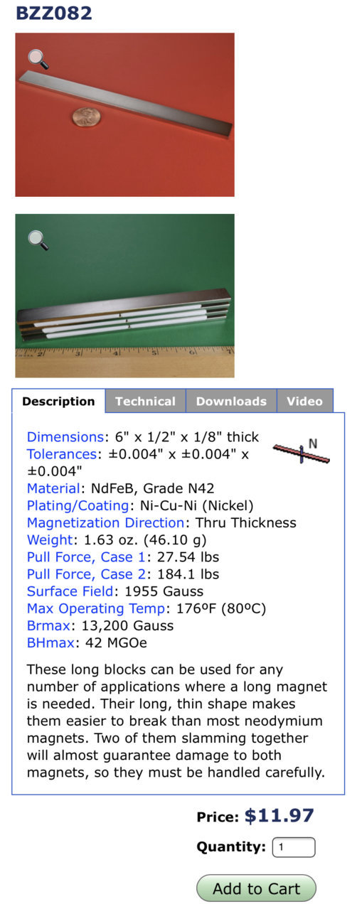

    I just purchased one rod and 5 discs.
