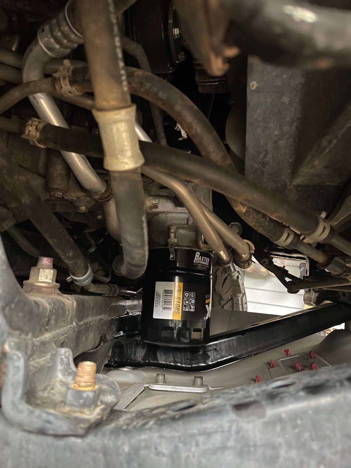

    My only concern about the spin-on filter kit is the filter is upside down.
    This can allow oil to drain out of the filter, resulting in a delay of X from a cold start while the filter is refilled.

    Nope…..the standard spin on adapter has the filter right side up.

    Yep looks like this

    Yep…….just like that

    Possibly the person was considering the relocation kit like I have that turns the filter 180 from the one shown. BUT! the filter has an anti drain back valve which keeps oil up in the filter so NO WORRIES.

    Sure……but the standard one is right side up
