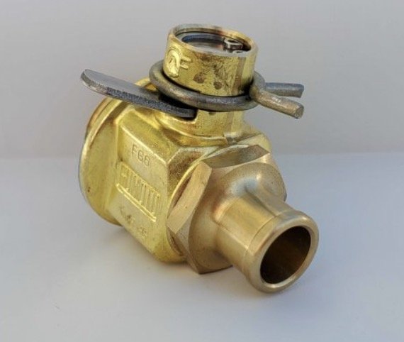

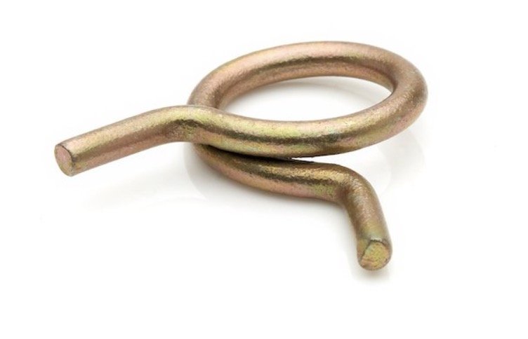

    Unbelievable that this entire 21-page 3 years-old thread has not a single mention of the heavy-duty spring clip Fumoto makes to help ENSURE that the lever on the valve cannot open accidentally, e.g. due to road or trail debris. This $2.00 clip is about 50x stronger than the little plastic clip that comes with the valve.
    Here, fixed that for you:
    https://www.tacomaworld.com/threads/fumoto-valve.325259/page-2#post-28228005
    To be clear, this is an official Fumoto accessory with its own catalog # etc, not some janked-up solution I DIY'ed with a pair of pliers and some fence wire:
    https://www.fumotousa.com/all-products/f-lock.html
    TacoTime55 and kcsyota like this.

    I looked at the TW thread and see that heavy duty spring you're talking about. That Fumoto looks flatter than even the short-knocker stubby one (I got the long neck).
    Anyhow, the small handle to open the valve is spring-loaded and according to my son-in-law, required heavy torque push action and side-slide to open the valve.
    I'm surprised the little plastic "Fumoto" cover had not flown off!

    Yep, bought one of these when I ordered my valve. Works positively to prevent incidental opening. I will say that I've used the plastic clip on my Subaru for over 6 years without any worries.

    Yes, do be sure to check part # compatibility, the Fumoto "F-lock" spring clip is only compatible with some of Fumoto's range of valves, not all.
    Since Fumoto's product is a $30 part with a potentially $30,000 to $150,000+ liability if it fails (causing an unseen oil leak,) I'm sure they have done vast amounts of design & reliability testing, even on this little plastic clip, and it is no doubt adequate for 99.99% of use-cases on paved roads.
    But I like the belt-and-suspenders approach of putting the massively-strong metal clamping spring on there for light-to-moderate off-road use. Let's say the truck is zooming at 25-35mph over mostly-open terrain with occasional bushes and maybe sticks/small rocks around that could bounce up into or catch against the valve -- that spring clip will be a lot more likely to stay in place than the plastic clip.
    For ultra-heavy-duty off-road use (basically, bouldering & driving over large rocks routinely, where there is any chance of a large part of the vehicle's weight hitting even momentarily directly on the valve body,) I would still go with a plain, solid steel drain plug. But that's in the 0.0001% use-case scenario I personally will never put my combination work/dailydriver/weekend-warrior truck in.
