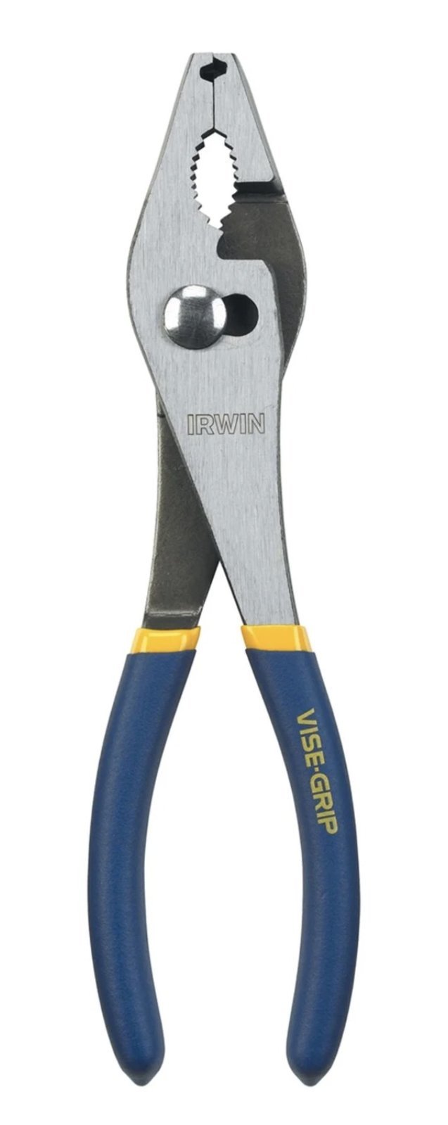

    Irwin™ part #1773627 or equivalent.
    It has a "detents" (if that's the right word) that allow gripping of the "ears" on larger spring-type hose clamps so they can be put on/taken off without the hose clamp "flipping sideways" and out of the flat jaws of a normal pair of pliers. Note also: while not shown in the picture below, it also has similar cut-outs/detents in the END face of the plier jaws, allowing the tool to be used in either side-on or end-on orientations, as may be required for tight access spots etc.
    As I mentioned in my other post, it is possible to take the Fumoto F-clamp OFF the valve with ordinary pliers or Leather-man type tool, but after trying 15-20 times to put it ON with regular pliers I gave up. The spring is stout and when it suddenly flips sideways out of flat pliers it is moving fast enough to cause serious eye damage or skitter 15 feet across the garage floor. Basically it's required have hose-clamp pliers to put it back on. I carry this tool in my on-truck fix it kit.
    https://www.freertool.com/products/irwin-8-hose-clamp-pliers-1773627-dipped-1-1132-ca

    Perfect, thanks! Was looking for pliers exactly like this so that the clamp can’t move relative to the pliers but I couldn’t find anything. Your post about using normal pliers is exactly why I held off on the spring clip because I wasn’t sure what pliers would actually work. With this, I think I’ll buy the clamp and pliers and finally install the valve, oil change is coming soon but I’ve still got time to accumulate the parts.

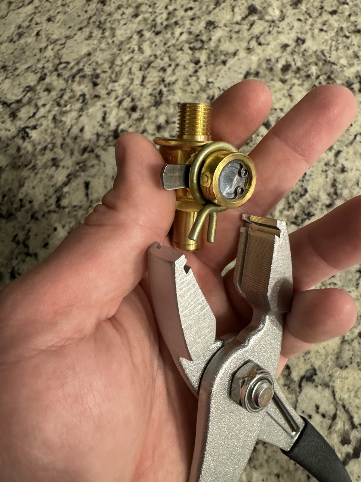

    Got my pliers and spring clip today. The Irwin pliers are not available, however I found a nice alternative on Amazon that works perfectly. They will go in my truck so I don’t lose them when it’s time for an oil change. Thanks for the suggestion.
    Powerbuilt Multi-Directional Hose... https://www.amazon.com/dp/B08TH864JL?ref=ppx_pop_mob_ap_share

    Perfect solution for the few here who think a Fumoto lends itself to someone slinking under your truck to either steal your oil or simply vandalize it I suspect. How disappointed they’d be after expending all that effort to find this stout clip.

    I guess I wasn’t clear what my point was. The point was few here, albeit likely very few, believe because a Fumoto valve can be opened WITHOUT a tool makes it susceptible to naughty things by evil doers. I guess a the evil doer could be a scorned ex-gf or ex wife?
    The stout spring changes the game a bit.
