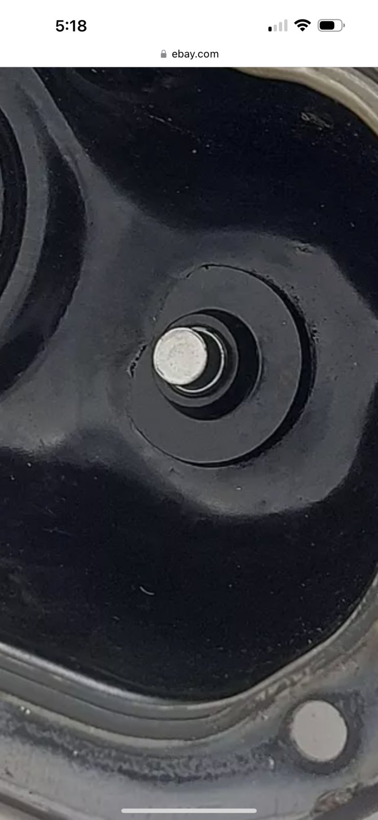

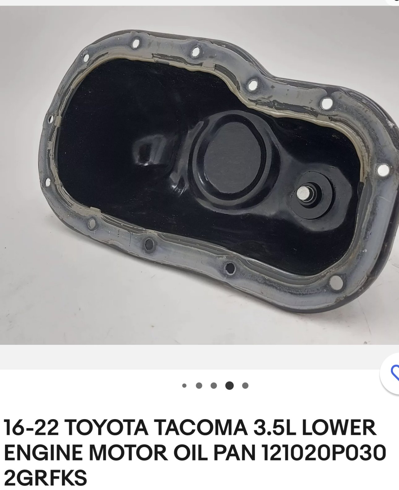

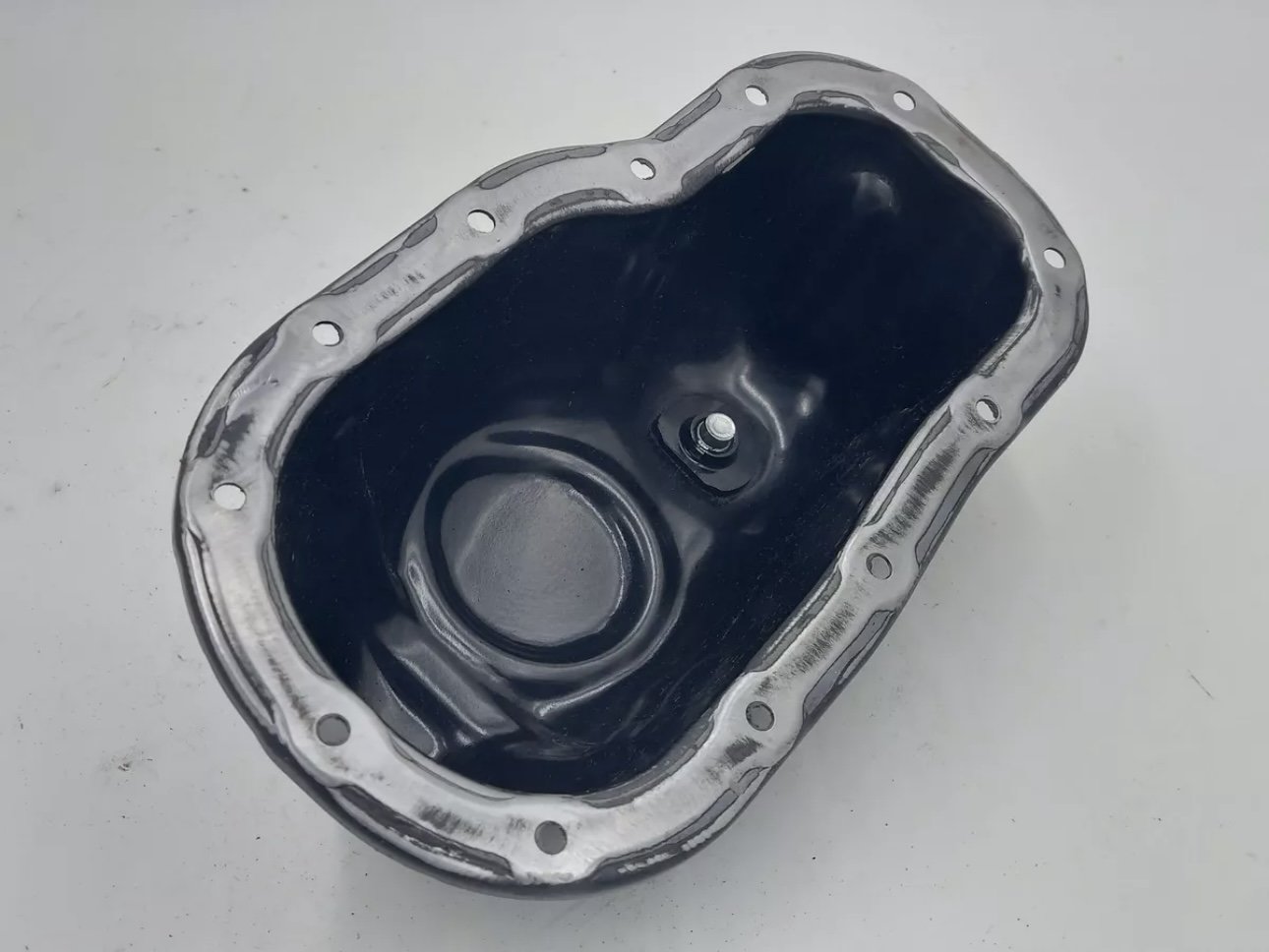

    That’s actually misleading - need a photo from the other angle (below) but there is a slit in that welded boss that lets oil out. I posted the same the other day but immediately deleted it when I realized that. The Fumoto not having a slit and extending above the boss means there will definitely be more oil than stock left in there. Negligible, but it is true that the Fumoto blocks some oil draining out.

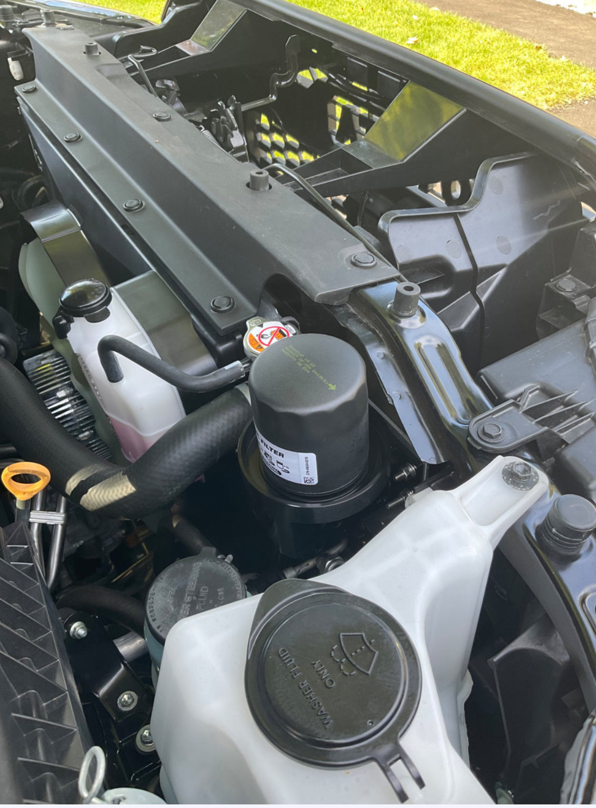

    Alrighty there tacotime, you’ve got some ‘splaining to do. I’ve double gloved before, but I’ve never double funneled. Is it just an extended funnel now?

    Clumsy me, with the aim I have...I need it to prevent splashing.
    Courtesy of the Auto Hobby Shop on Dover AFB, Delaware!
