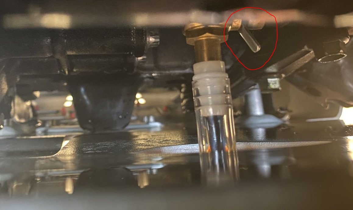

    Here's my set-up.

    Here's the long nipple...well under the TRD Skid.
