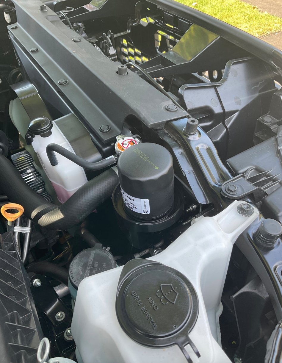

    Yep, that amount of oil is insignificant unless you have an extremely long oil change interval. If you are changing your oil every 10k or less I don't think you have to worry. The greatest risk we have with our oil is its contamination level. I mitigate this by using the best filtering media I can get and change the filter every change. Because I have a Baxter relocation kit I actually use a spin-on filter now. I get the largest filter available and use synthetic filter material that can filter at 20 microns. Here are my filter choices. Amsoil EAO34 or WIX 51393XP.

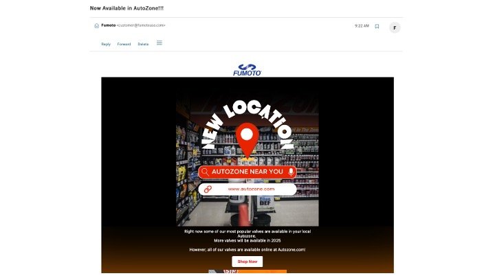

    Fumoto's now available at Autozone. I just received the email below.
