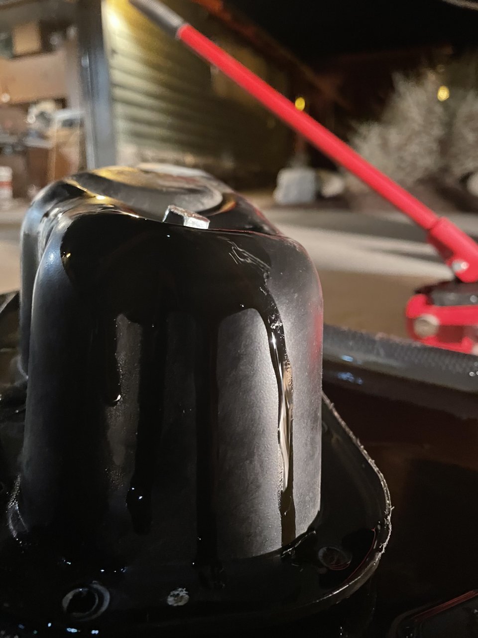

    $yoda$
    $yoda$ Well-Known Member
    Jun 11, 2019
    #296087
    1,948
    Tom
    2007 Tacoma 4.0
    2.5 inch lift, 285/75r16s, upgraded stereo system, Magnuson mp90 supercharger system.
    I don’t think anyone is saying it’s a frequent problem only that is could be a possibility. It would look something like this. 1BD8B0B4-1284-47A7-97C3-74CE7193AF36.jpg
    mallege and CrufflerJJ like this.

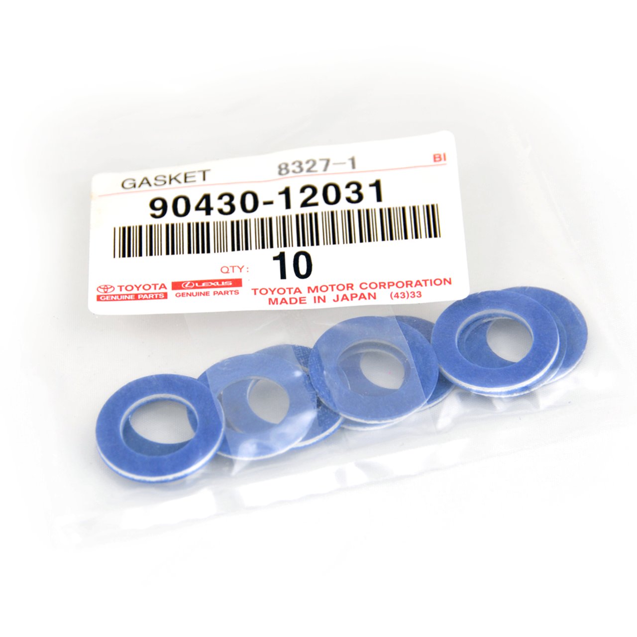

    Anton338
    Anton338 Ill-Known Member
    Oct 10, 2010
    #44454
    298
    Anton
    New Jersey
    2018 TRD Off-Road DCSB
    Mostly electrical shit that nobody cares about.
    This is not the correct OEM washer to use on a 3rd generation drain plug. This is:
    OEM Part number 90430-12031, and you're supposed to replace it every oil change.
    So I agree with your post for the most part. Unless you don't have a skid plate, (or you have a fragile masculinity) there is no reason not to have a Fumoto.
    I'm also an engineer. You know, it's okay to introduce a calculated "point of failure" if the benefits are justified. In this case, the benefits are abundant and the risk is minimal.
    I'll give it to you. You're the first person to mention "oil drain plug security" in a Fumoto thread. And yes, I believe this is more likely to happen than a rock shearing off the drain valve during off-roading. Having said that, I'm still not worried.
    jackn7 and mquibble[QUOTED][OP] like this.
