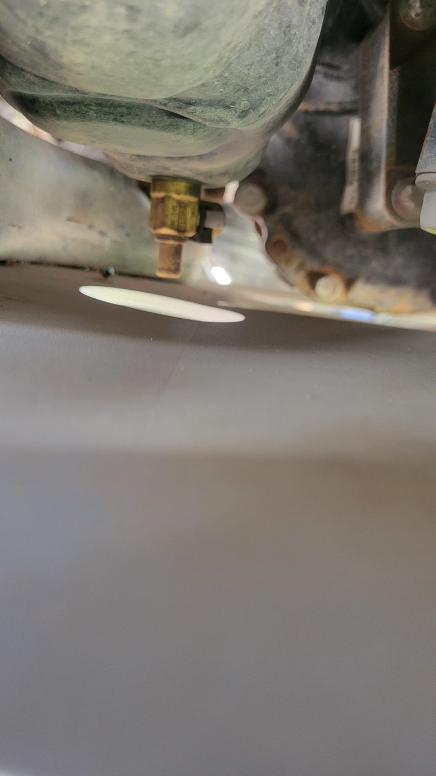

    Here's a pic from below

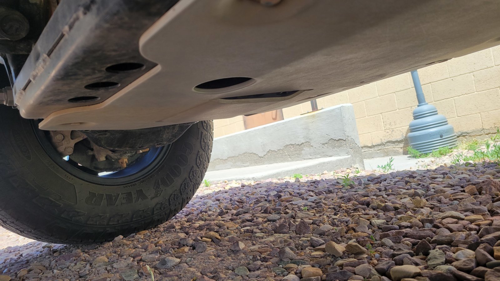

    And one from the side to show clearance.
  11. Jun 15, 2024 at 11:01 AM

    I disagree. The longer nipple lets me push the rubber tubing further up and makes it less likely to pop off if it's bumped around a little.

    Thanks!
    Thats perfect and just the angle I was looking for.
