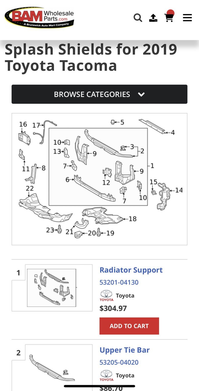

    The parts breakdown actually lists them as splash shields…..I thought they were listed as pans

    Yeah ... parts 18 and 22 would be crushed running over a tall speed-bump. :crazy::facepalm::notsure:

    Yep…..or road debris other than McDonald’s trash
