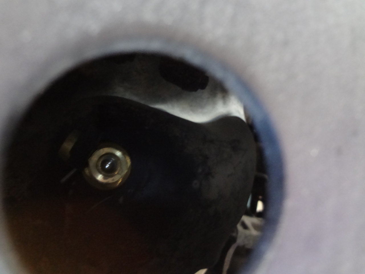

    Bought a 'Fumoto' oil drain valve (F133S, short nipple valve w/12mm-1.25threads w/lever clip), intending to use it with a 'Budbuilt' front skid plate.
    I read on a few threads here of folks doing this (w/out having to remove the skid plate of course), with this type of drain valve (short nipple and all).

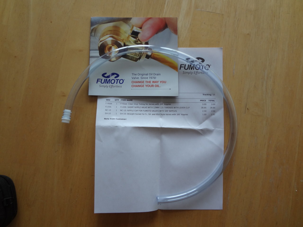

    Can someone please tell me what I'm missing here? As I'm going to have to remove the skid plate soon apparently to change oil. I did buy the 'short nipple valve', but I saw others who had done so, and said it could be used w/out removing skid. I did buy the clear vinyl tubing to assist in draining, but am obviously missing something.

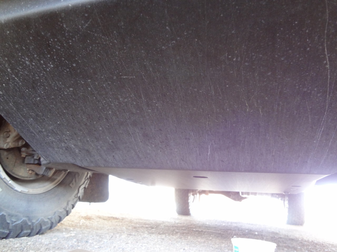

    Pic's attached mostly for some basic context. The oil drain hole in skid is 1 1/2", the valve is about 3 1/2" away from bottom of skid (as can be seen in pic., why I included these pics, IDK, lol).
    I'm beginning to wonder if I'm better off with the OEM oil drain plug, and tooling up through the drain hole. I can't seem to tool/or put a finger on the fumoto as is.

    Could make the hole large enough to stick a few of your sausages in there to actuate the valve?
    Mine doesn't really line up with the hole perfectly anymore because the hole is in the correct place for a 5VZ drain plug not the 1KZ, but it's ok because the skid plate acts as a big drain pan that funnels the oil to whichever side is downhill.

    Just make the hole larger, or undo the front 3 bolts to drop the front and gain access to the lever.

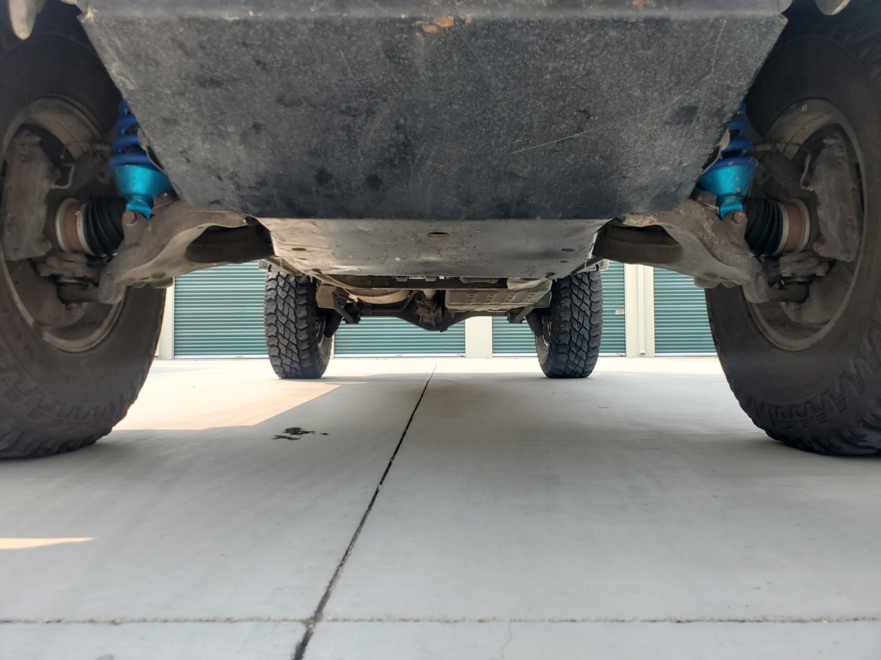

    I do have the same skid plate.
    I just topped off my front diff 2-3 days ago and did so by loosening the rear 2 almost all the way, so that when the plate hangs, the bolts don't get damaged.

    Looks like a Major leak !!
    How is the concrete so clean and not any ice or snow??

    It's water from the A/C running :rofl:
    That pic was taken while at my storage.

    Even if you figure out how to open the Fumoto with the skid plate on, you'll want to take it off for changing the filter or you'll end up with motor oil all over it.

    Because of the location of the oil filter on the 3.4L engine, it's almost unavoidable that you'll spill some oil when removing the filter. The oil drips down onto the front differential and skid plate if you don't take steps to mitigate it (there are whole threads on this topic). Some people will change the oil without removing the skid plate, but if you want to keep things clean down there you'll likely need to remove it.
    I say keep the Fumoto and use a floor jack to help lower the skid when doing the job - it looks heavy.
