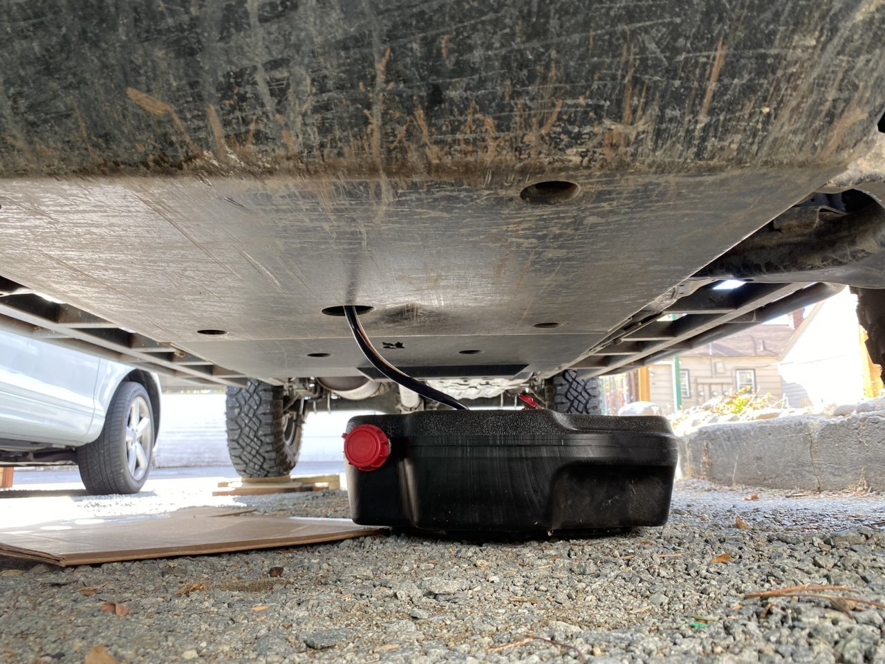

    Fumoto valve and a short hose means I can drain oil without dropping skids

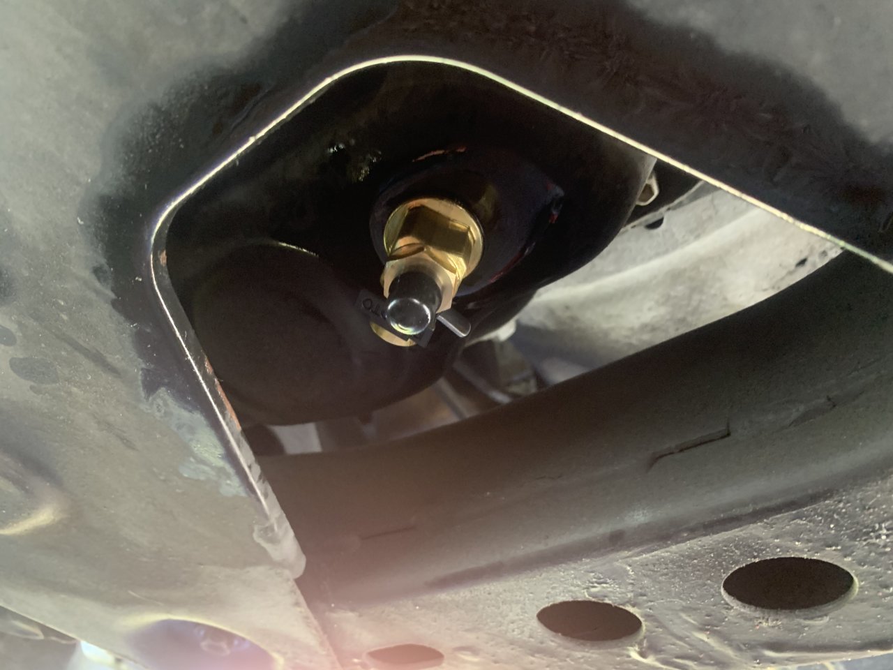

    Well I installed my fumoto valve finally , switched the truck over to Mobil 1 synthetic today . The valve is tucked up in front of the cross member and the factory “skid plate” is helping protect it . I got the newer version of the valve I guess which has a larger opening for faster drains . I also used the little clip that protects from accidental opening of the valve (and the little black cap that protects from dirt and debris from getting up in the valve ) note it doesn’t hang down below the opening

    I've got the short nipple on the 1GR and it drains just fine with the stock skid plate (splash guard). No need to use a hose but I've got the hose assembly and it works fine too.

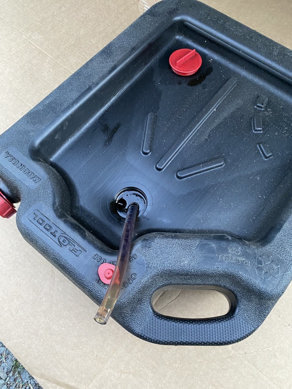

    Any input on which works best with a hose?

    3,992
    2015 Access Cab V6 4x4 SR5 MGM
    The short will actually work with a hose also.

    stickyTaco
    stickyTaco Fuck Cancer
    Dec 11, 2012
    #92904
    5,930
    Zack
    Reno/Tahoe
    '12 DCSB TRD-OR
    Fox/Dakar with Relentless goodies and stuff
    They both work with a hose. Super clean oil change.
