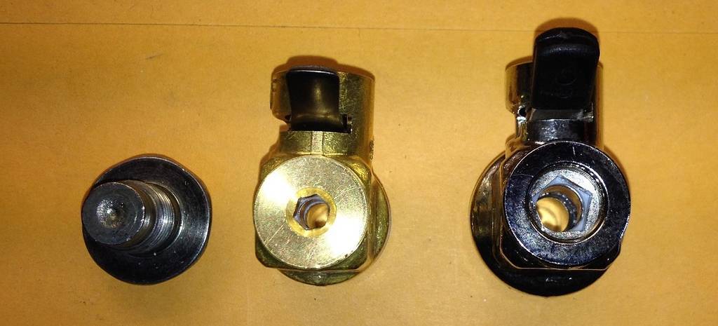

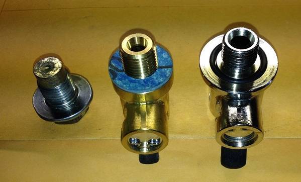

    I bought the Fumoto F-103 and EZ-103 drain plugs for comparison. (There are 4 Toyota products in my household; so, neither will go to waste.) I'm leaning towards the EZ plug as my 1st choice. It has a built-in o-ring but you can install a gasket as I did on my wife's Lexus. The big difference is the opening. The Fumoto allows a 3mm bolt at one end but does not go through. The EZ valve accommodates a 4mm screw all the way through with a little wiggle room to spare. Next time I change the oil in the Lexus, I will move the EZ plug to the Taco and see how it does there.

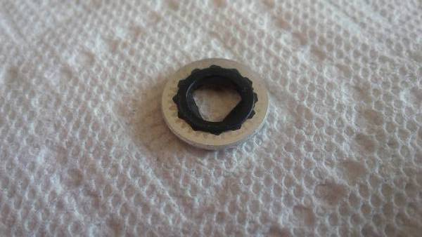

    Love the Fumoto...
    I put one on at 25K miles after my Toyota love expired.
    Now have 78K...no drips/leaks/failures. Change oil & filter every 5K...it's a breeze. It does take longer to drain than the stock plug...but for me, this is a minor issue.
    Also, I used this seal washer instead of the stock Fumoto washer...
