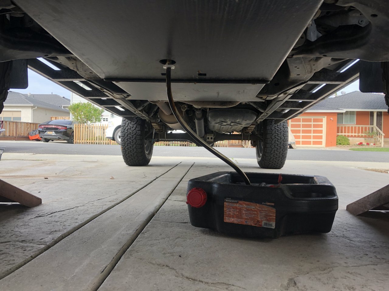

    I am running the 103N Fumoto Valve with BAMF skids. There is a good inch or so above the skid clearance between valve and skid. Plenty of room. If you have some solid skids the Fumoto isnt going anywhere.
    It is also pretty awesome if you run it with a tube like in the photo. Simple and clean.
