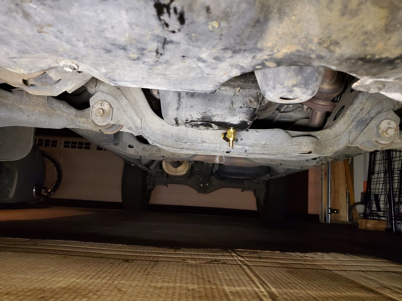

    I finally installed mine. But I have the F103N, its slightly longer. It appears to be right at the same level as the cross member. This doesn't worry me because I am not doing anything crazy in my truck.
    If the length is a problem for some, the F103 doesn't have a nipple at all, so its short. They also have a F103SX that uses a banjo bolt and the valve nipple comes out to the side. Too many potential leak points on that style in my opinion.
