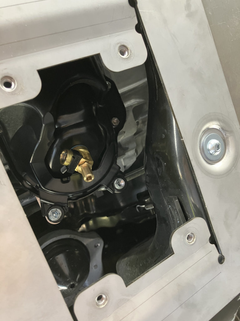

    You don't need special bolt or torque wrench---- I added one when doing my oil change and the instructions just made a point of stating to put wrench on valve body itself (not the nut) and to not over tighten. If I remember correctly, not more than 1/4 turn beyond hand tight. As mentioned above, a clip is included to secure the lever. Here's a pic of mine (got the version w/ nipple so I can connect drain tube from valve into bucket). If your oil pan is lower to the ground this one may not be good for you, but it's nice when up high enough to not get hit.
