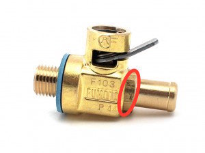

    I just put a wrench on the valve body itself. Just snug it up tight as it's brass.

    So not too concerned about getting the correct torque? I thought maybe using a crescent wrench on the valve body itself might be safer as I don't know how the Fumotos are put together and wasn't sure if torquing on the hex part was safe or not....

    No DO NOT torque the red area. Use a wrench for the squared off area just above the red area. I did that on my first valve and snapped the threads off inside the valve. Hand tight has done the trick for the last 3 years. FYI it works great and I highly recommend it.

    Exactly what I needed to know!! Thanks man :thumbsup::cheers:

    In the instructions it states: 4. Torque: Tighten the valve with a crescent wrench on the body of the valve* an additional 1/8 to 1/4 turn. Do not over tighten.
    *Do not use a wrench on the hex head if present

    Thanks for the info!!! I don't recall seeing any instructions with the valve when I purchased it and I neglected to check the Fumoto site for install instructions (my bad).

    No problem. To be honest I can't remember if there was a small leaflette with the valve or I ran across them on their site. Here is a link to the instructions on the Fumoto site: Standard & SX Fumoto Valves
