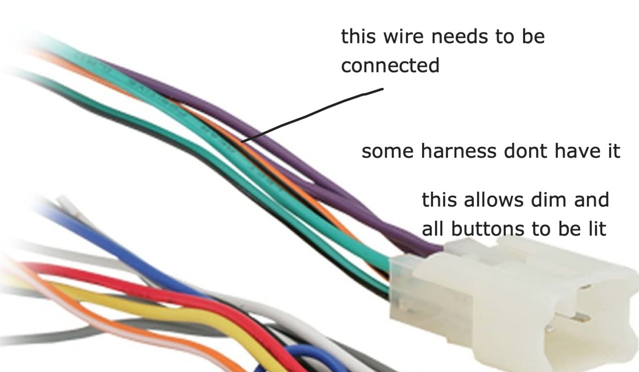

    the problem is the orange wire coming out of the rear speaker section. it is not connected. someone might have added an aftermarket amp. the harness they used did not have the orange wire coming out of the rear harness so its not connected. you have to tap into that from the factory harness. if you still have an issue with this we can keep the dialog going.

    some harness for aftermarket amps do not include this wire in the rear speaker section. this must be connected in order for the buttons you are asking about to be lit, the volume and side buttons.

    I think his :confused: is more that this thread is from 2018. But the lights around his button work just fine when the headlights are on, so that would mean that wire is still intact. His problem is actually a "feature" on these trucks. The radios button illumination is tied to the dash lights. No dash lights = no radio lights. The only way to have the radios lights on is to turn on the headlights, but when doing that it dims the screen making it hard to see in the day.
    Its a shitty feature, but its normal.

    got ya.. yeah, i know its an old thread. but i dont think they delete these, they leave them up in case it can help others. i just found it. if it can help someone then fine. if not, keep scrolling. with DLR on , all buttons are lit.
