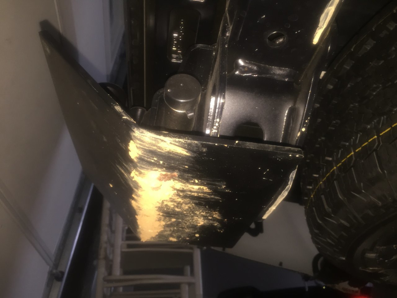

    A hitch skid solved the departure issues for me. $100 or less including a rattle can versus $500-THOUSANDS of dollars and a rattle can. :thumbsup:
