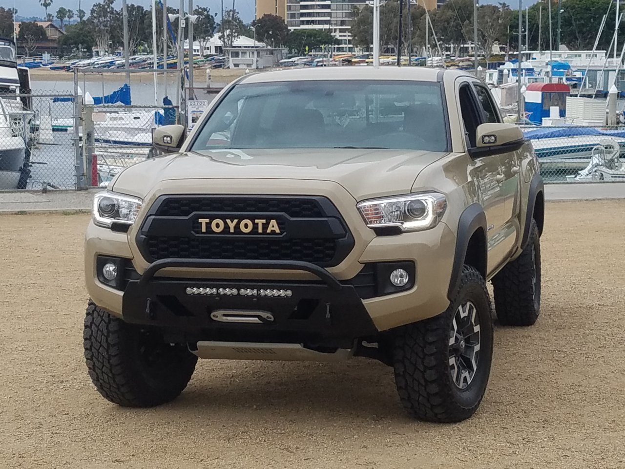

    BD S8-20 in "driving combo" configuration light bar in winch bumper.
    BD S2 pro in wide cornering mounted in mirrors for ditch lights.
    About all I could want for front and ditch area lighting. Really lights things up well with about a 180* arc of light from a-pillar forward.

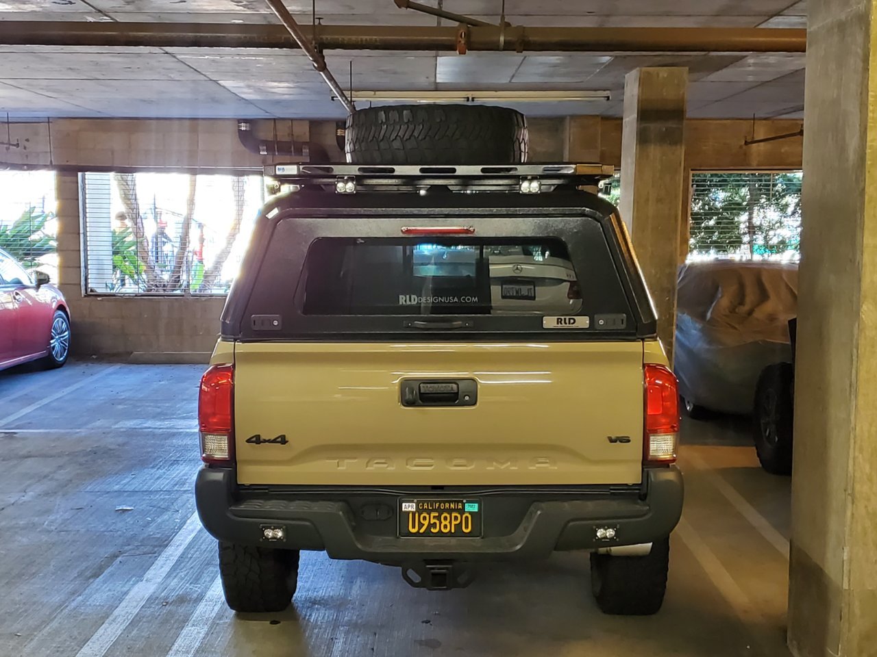

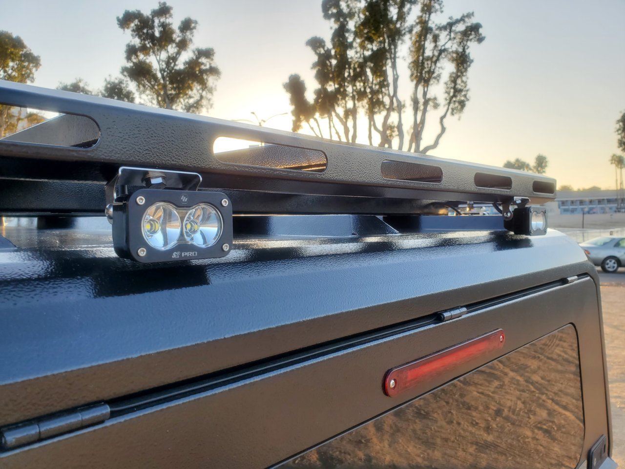

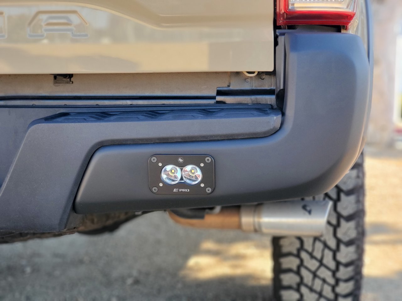

    Then BD S2 Pro work scenes in rear bumper for backup lights, and more recently BD S2 Pros (work scene) rear facing on roof rack, and BD S2 Sports in work scene to the sides.
    With that I'm done with exterior lighting. Next up BD interior led's for inside the canopy.

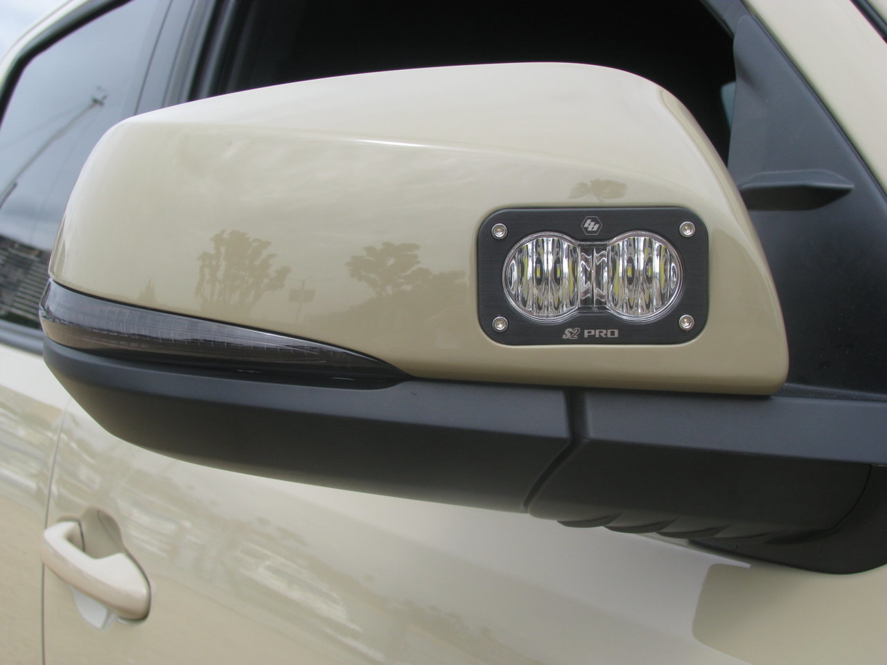

    Now if that ain't a trick way to mount some ditch lights. Was that your idea or a product that is sold by someone? Either way super creative! How's the angle? I like my ditch lights pointed way over to the side, does it spread wide enough?

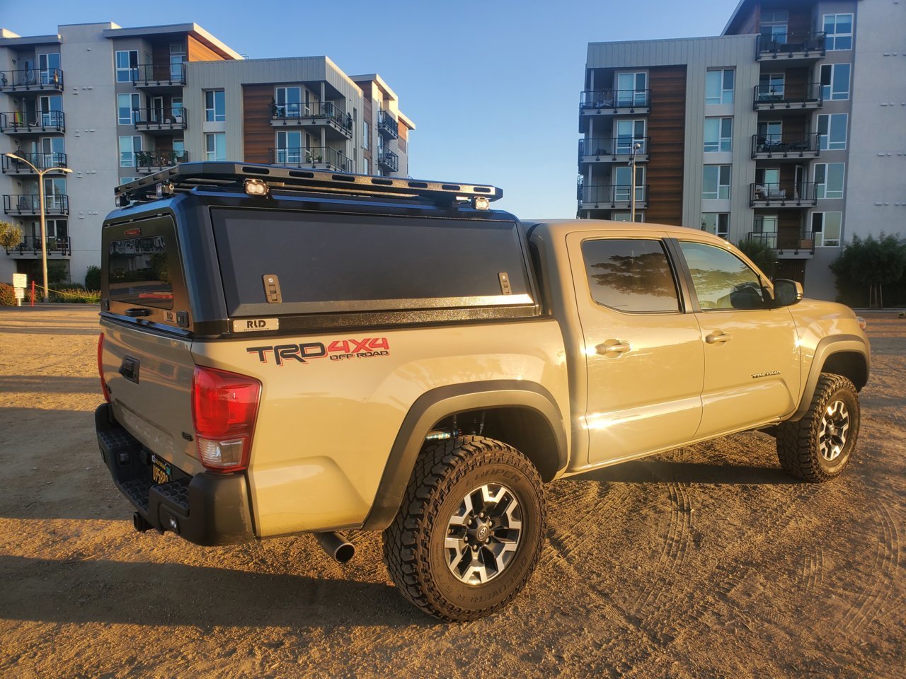

    I have a very similar setup and have found it works extremely well when driving into the night in the desert or arriving late at camp. 30" driving/combo lightbar stealth mounted in stock bumper, BD S2 Pros (wide cornering) for ditch lights (no fancy custom mirror mounts, just plain ol' brackets) and BD S1s (work/scene) mounted on the sides of my ARE CX HD canopy for getting situated at camp. Ive got another set of BD S1s that are going into the bumper and want to do a few rock lights (in amber as camp scene lighting), just have to find time.

    Okay, that is clever. I love that it doesn't have the big ugly cubes sticking out. Alas, probably not for me because I'm always using the foliage to fold in my mirrors.

    Not my idea. Meso started the mirror mounted ditch light thing with Rigid Ignite Floods as I recall, and then this was robmpii's take on that using BD S2's.
    https://www.tacomaworld.com/threads/mirror-mounted-baja-s2-diy.599067/
    It was quite the little project. Fun, and came out well, but with cutting, painting, positioning, etc., it was not a quick job.
    I've had quite a few people come up and ask where I bought them, then they get disappointed when they learn it is a DIY job.
    They give good lighting off to the side for cornering on sharp turns on the trails. If more light is needed to the side, it is as simple as pulling the mirror in a bit. But these work just fine for me in the standard mirror position. Plus I've now got the rack mounted side lights (which can be turned more forward as well) if I need more lighting to the ditch area.

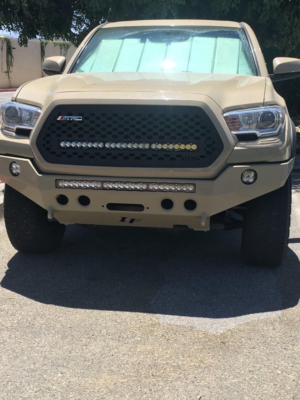

    OVT 1.03 Tacoma bed matt Husky floor liners Insain fab aluminum bumper with Baja design s8 30" light bar DB custums grill with Baja design s8 30" light bar
    BD S8 30” x2
    One in the bumper one in the grill
    Bumper is flood pattern and grill is spot pattern combined with BD squadron sports in the fogs. All the foreground and distance light I need with no hood glare.
