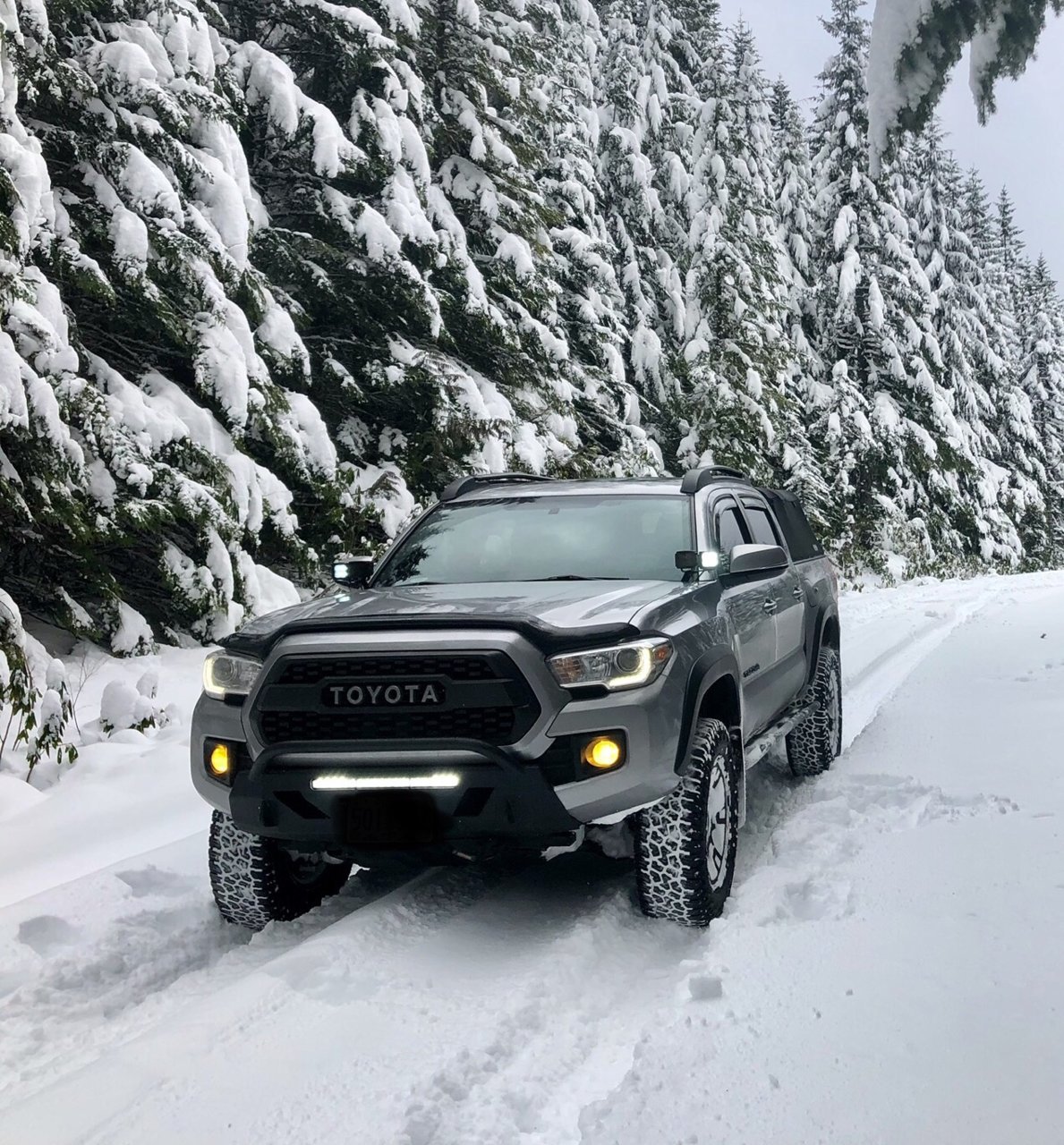

    The Falken AT3’s work better than the BFG AT’s in the snow too. Never been stuck once

    Yeah in my last taco i was going up 19-22° incline switchbacks with 16" of snow over ice. The going was pretty shit until i remembered i had a locker. Then it was fine. I also had chains on all four tires. But hell. Aint no tire im aware of that climb a sheet of ice without cables or chains.
    As far as modulating the clutch goes, you're gonna burn it sometimes trying to ease out if your stuck. There's no good way around it that I'm aware of. I would just always try starting out in 4Lo if your in deep snow. Otherwise the tires will just spin from the friction loss when the clutch grabs, that will compact the snow and then you have compacted snow under your tires. Its the shit.
    In my 17' taco i got stuck in 6" of snow on gravel with my stock tire like a week after i got the truck. Pulled it out with my other taco that had cooper stt pros on it. Then i put cooper STT pros on the 17' and never had a problem again.
