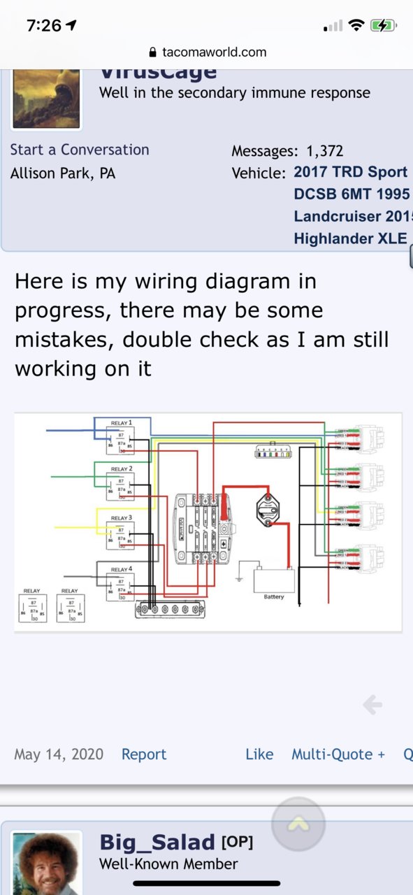

    Bump. Hoping to get some info. I did some research and found out some good info but had a couple questions I was hoping someone knowledgeable could help me with.

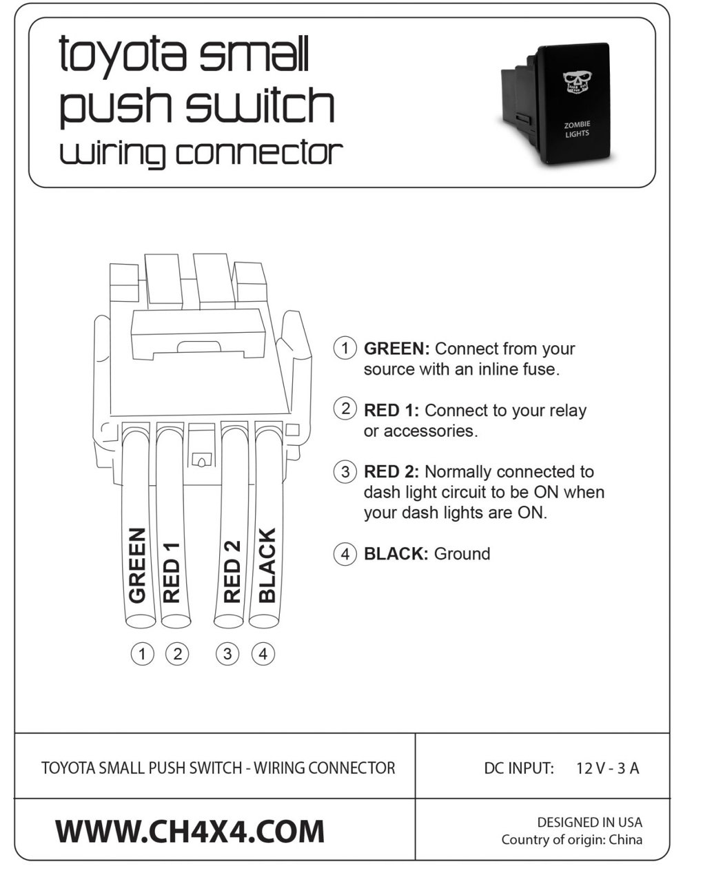

    The post above is something I had a question about. This is using the ch4x4 switches (below); does this setup mean that the switches would always be “hot”? Meaning anything they control can be turns on with the truck off?
    If that is correct, if I wanted to make the switches hot only when the truck was on, would I just tap all of the green wires from the switch harnesses into a switched fuse (inside the cab)? If so, what size fuse? From what I am understanding, using relays keeps the draw low on the switches themselves, so the Andrade should be fairly low?
    Sorry, I’m a complete newb at this and just trying to make sure I fully understand.
