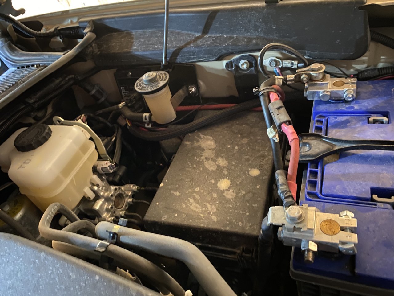

    Here’s how my switch pro is wired (ignition - blue wire, illumination - white, trigger - pink)
    i assume you can do the same thing with the spod

    I just need the ignition power to trigger one of my devices to come on automatically when I start the car...my cell booster. I’ll try that location where your blue wire goes and give it a go. Thx

    Mounted by the clutch reservoir and they follow the factory wiring into the fuse box. You take out a 10 mm from the factory fuse box and you can come in with all the factory wires. It’s super clean
