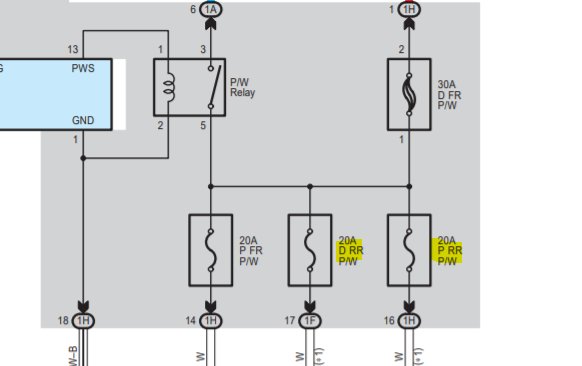

    Do you have a access or regular cab? If so, you can use the rear power window fuses which are rated at 20 amps. Even if you have a double cab, put the window locks on and tap into that circuit so you don't use the horn and a window at the same time. Ashame Toyotas don't come with upfitter switches or a customer accessory fuse like the fords do, to give you aftermarket options though. For the price they charge you, a few extra feet of wire and fuse wouldn't be terribly more.

    @6 gearT444E Access Cab.
    Right now, I'm thinking the stock wiring is good to run the 4 tone horn system with 11A draw on a 15A fuse. But I need to verify the wire size on the truck for the horn circuit.
