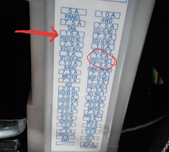

    Is there a way to tell if a fuse is bad? My cigarette charger hasnt worked since i purchased my used 2018. Just searched this forum for solutions. Just seems odd that a fuse would go out on the charger

    Yes, pull it out and look at it. Or test both sides with a test light or meter. Someone could've spilled water on it.

    Well? I have same problem w my 2020 Taco limited. Worked and then just stopped Mu fuse box is in engine compartment. None look blown. The map of fuses is cryptic and nothing helps in the owners manual. LAME! So disappointed. My dealer is a ride away. 11th car in my life. Never had this problem and it ahould be a simple fix.
    does anyone know what fuse it is?????

    My truck does not have under dash. There is an airbag there. The fuse box is in under the hood. Just like the pic posted.

    Found it. This other fuse box is actually behind the plastic cover under steering wheel. You cant see it unless u r on your back. Pull cover off. Replaced 15amp “Power outlet no. 1”. Works. Thanks peeps. !!!!

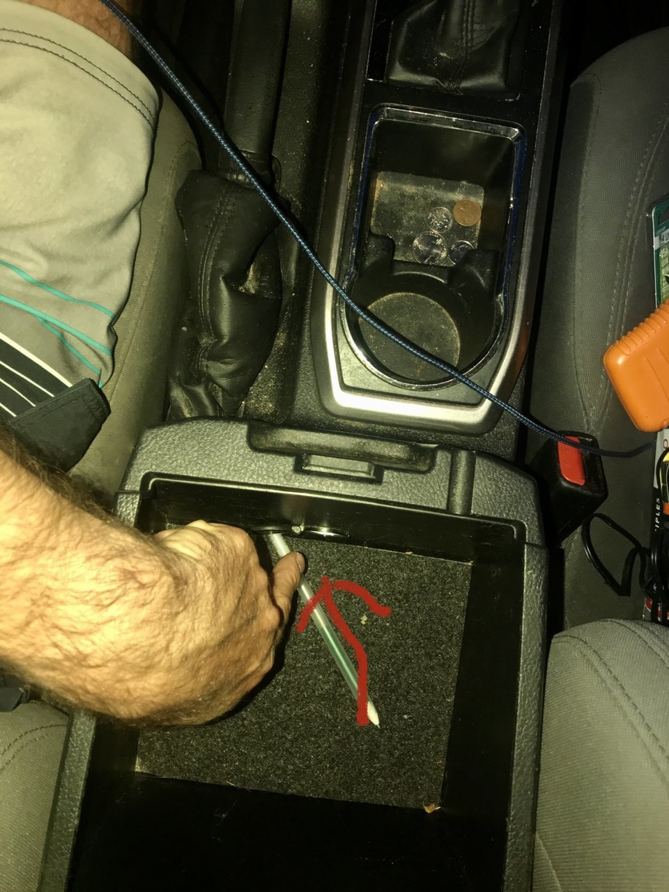

    This thread had been very helpful as Toyota has done it's best to make sure only Dealer Mechanics know which fuse is which. Does anyone know what "P/OUTLET NO. 2" powers?

    "P/OUTLET NO. 2" powers the outlet inside the center console armrest behind the hand brake and gear selector

    Thank you I've been trying to locate the fuse for my console outlet . Been out for awhile now . Today I'll replace.
    Thanks again
