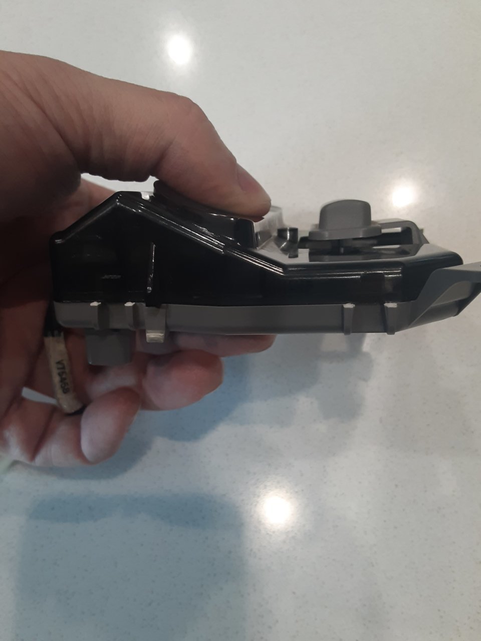

    Well I finally got to this project and broke 3 of 4 clips separating the lens from the grey plastic and circuit board. I read advice to be careful and I was.. but they flaked off. Part number 83290-04030 is a combination of the plastic piece and the board for between $130 and $250. I called the dealership and they simply don't sell just the plastic piece. It almost looks like I could do a solid tape job and join the lens back with the plastic piece. I could probably glue it too. Does anyone have any advice? Thanks

    Tape
