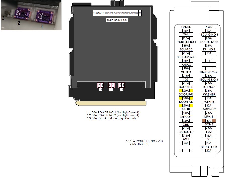

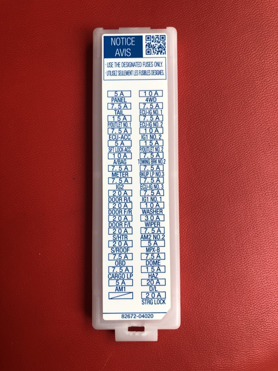

    Should be under your steering wheel left kick panel area.

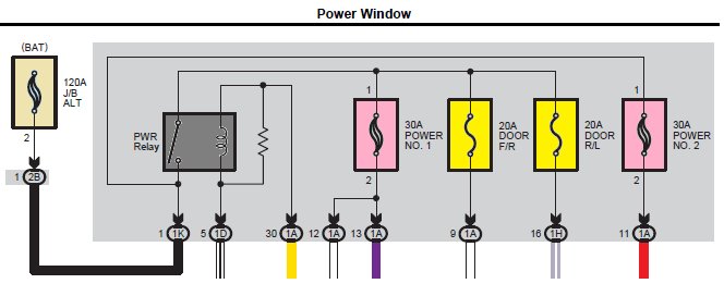

    20A Door and 30A Power fuses should be the ones
    Well let @caribe makaira confirm it.

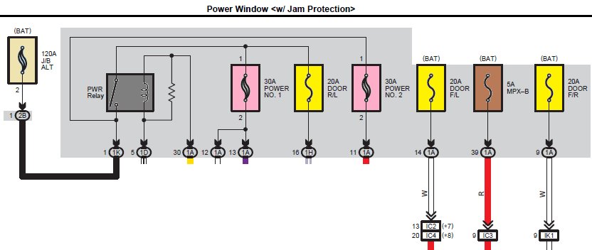

    OP, when you state window "control", switches and an ecu in each door (depending on type) do this. Does your Tacoma have anti-jam feature? It's to prevent getting the body part pinched between glass window and frame.
