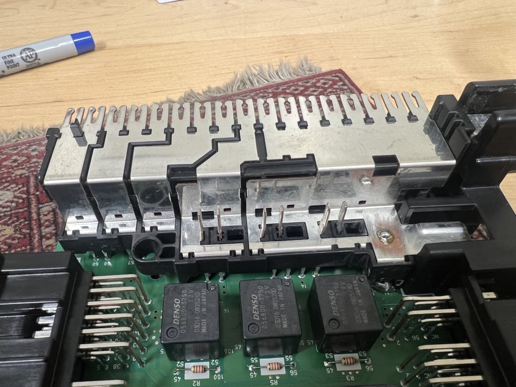

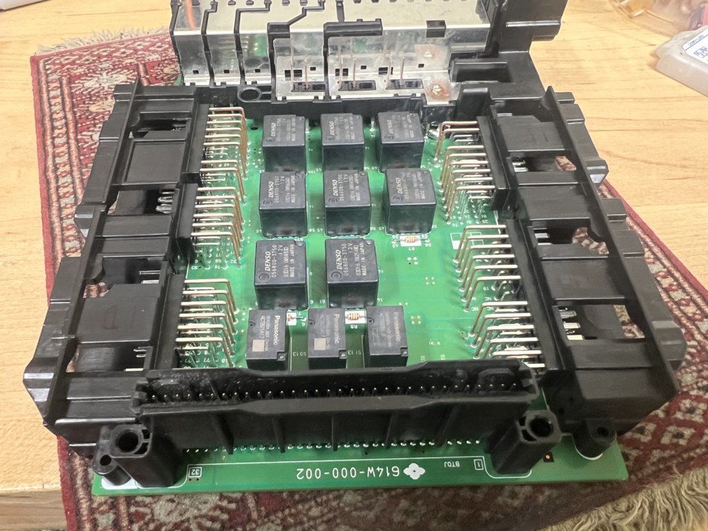

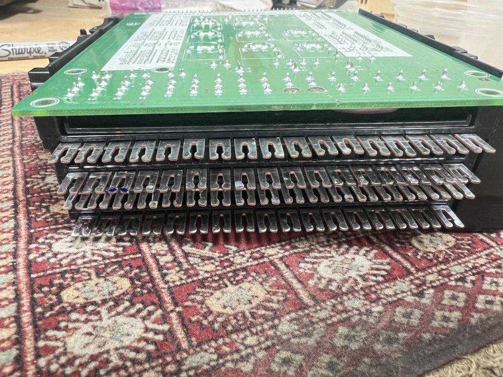

    Here are a few pictures of the inside of the fuse box:
