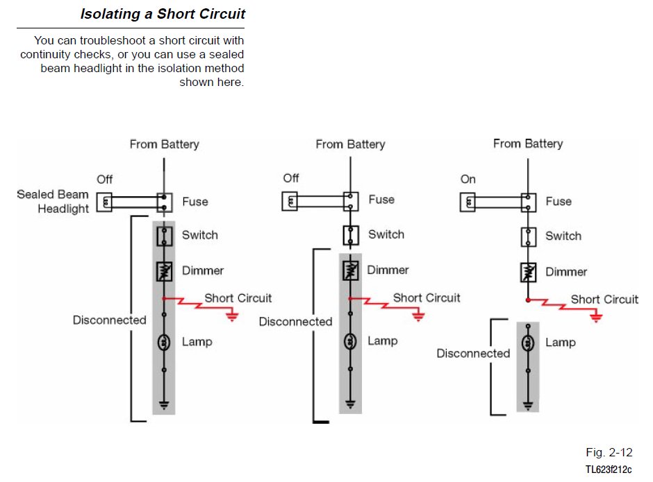

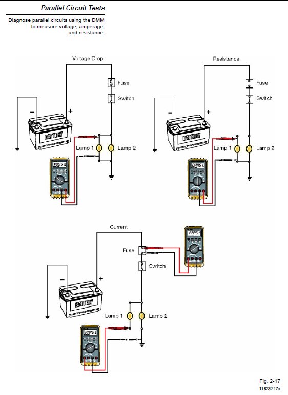

    Measure from fuse load to ground and see what ohm value you get. You'll have an idea if you're dealing with a direct short or something above the amp rating of the fuse.
    Replace the fuse with a bulb can be helpful for troubleshooting. Start by half splitting the circuit and energizing known good loads, add on loads slowly while monitoring current.
