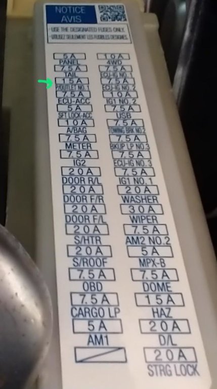

    Just added the USB to rear of the console, I T tapped off of the cigarette lighter in
    the console and i have now accidently popped a fuse somewhere, I looked for a
    blown fuse in the cab fuse box and the fuse box under the hood. I dont see a
    blown fuse with these bad eyes, can someone tell me what fuse is the one that
    protects the in the console cigarette lighter, this would have been an easy job if
    hadnt let the wires touch.

    P/outlet No.1. 15A cabin fuse box

    That fuse was blown and i replaced it but it still doesnt have power going to it, could there be another fuse somewhere?

    I found it, there was another fuse P2 and both were blown, thanks for steering me in the right direction folks!

    Where did you find the P2?

    On the other row 5 fuses down, on my cover it shown it also was 15A

    P/OUTLET #1 15A on left and
    P/OUTLET #2. 15A on right hand size

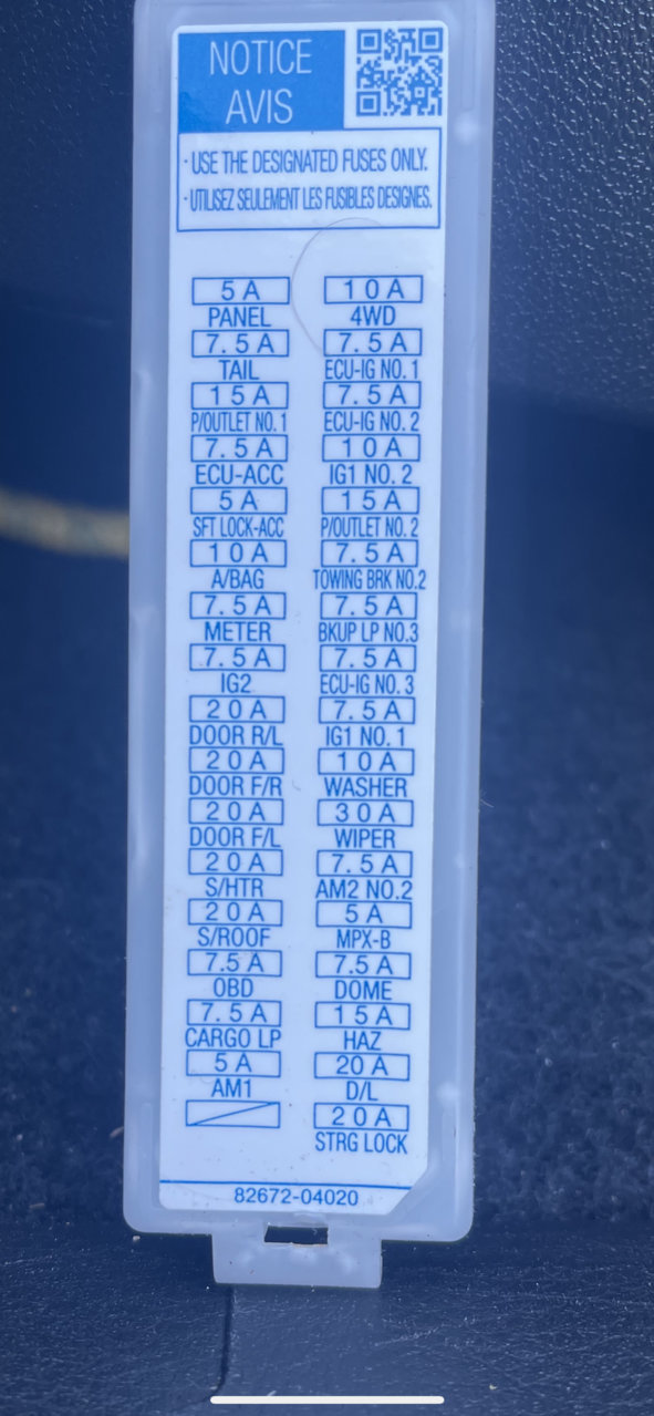

    The label changed from P/Outlet No.2 to USB some time before the 2020 MY. Take a look at the images in the quotes below and you'll see.

    Thanks...that helps as I have a ‘19...
