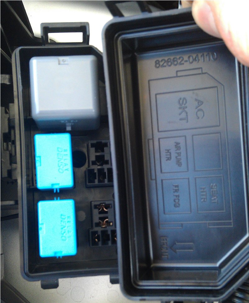

    Does your Tacoma have this?

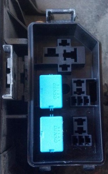

    Or is like this :(

    Yes it does.

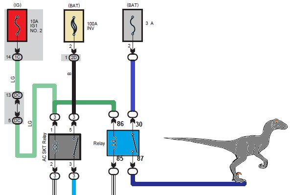

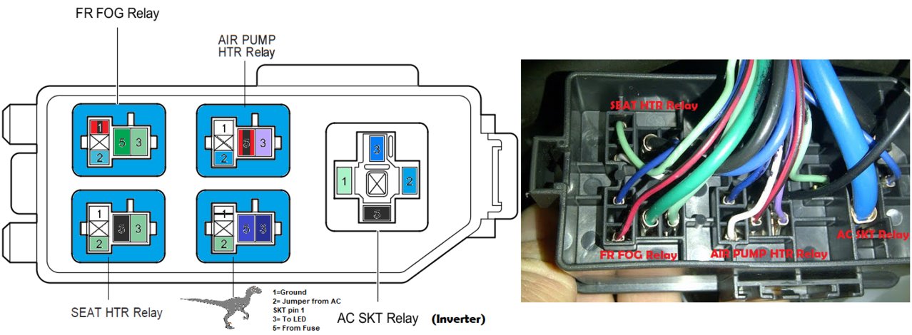

    Then you could do this:
