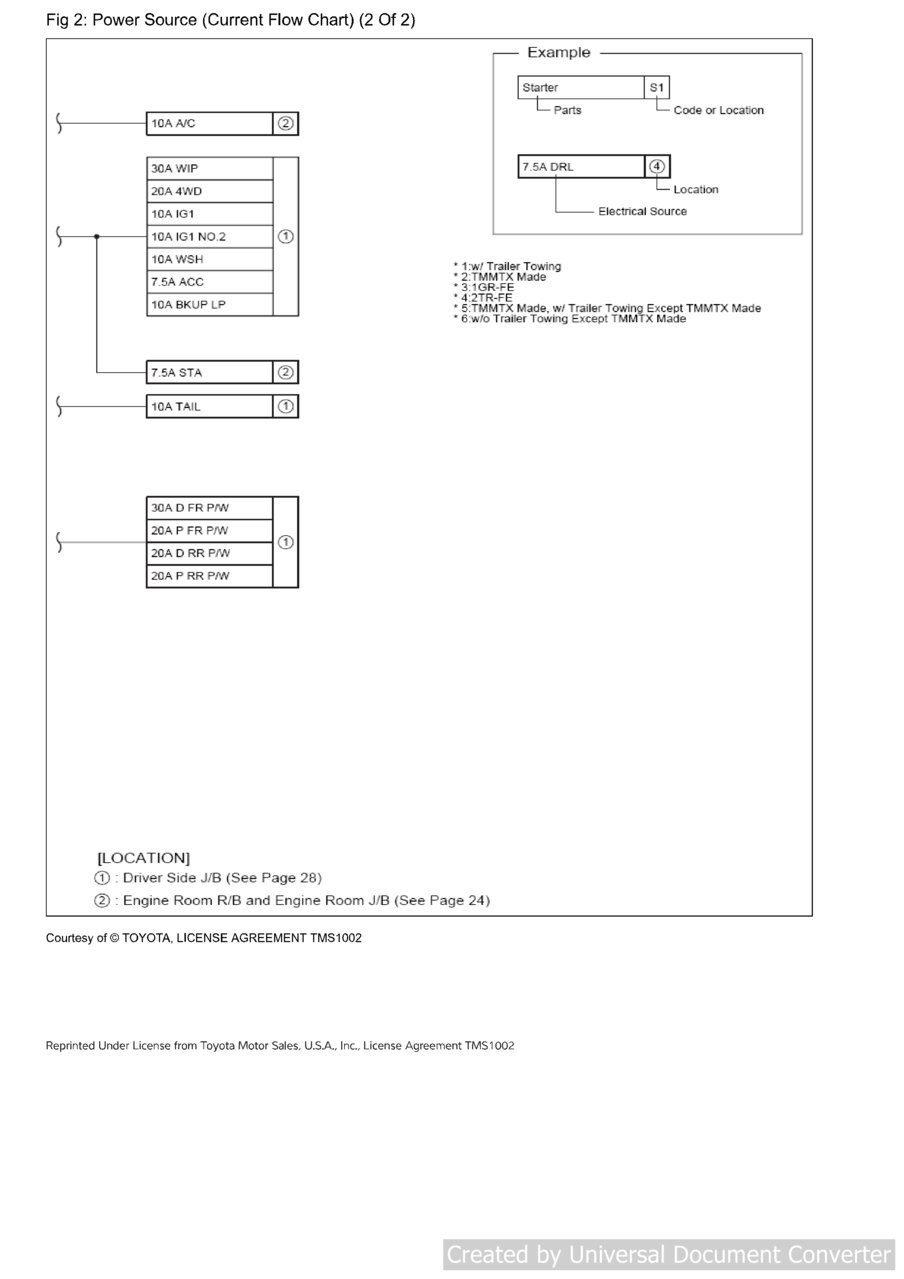

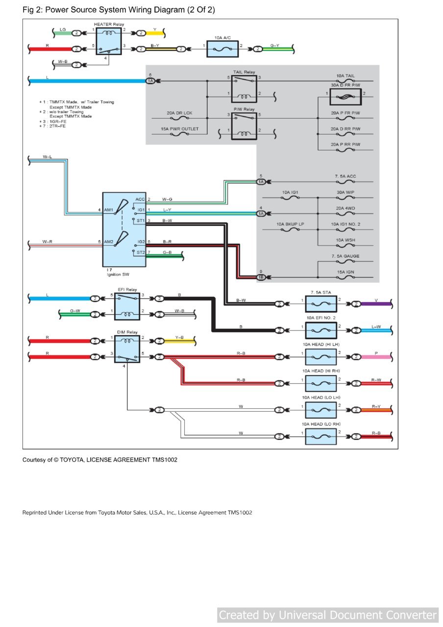

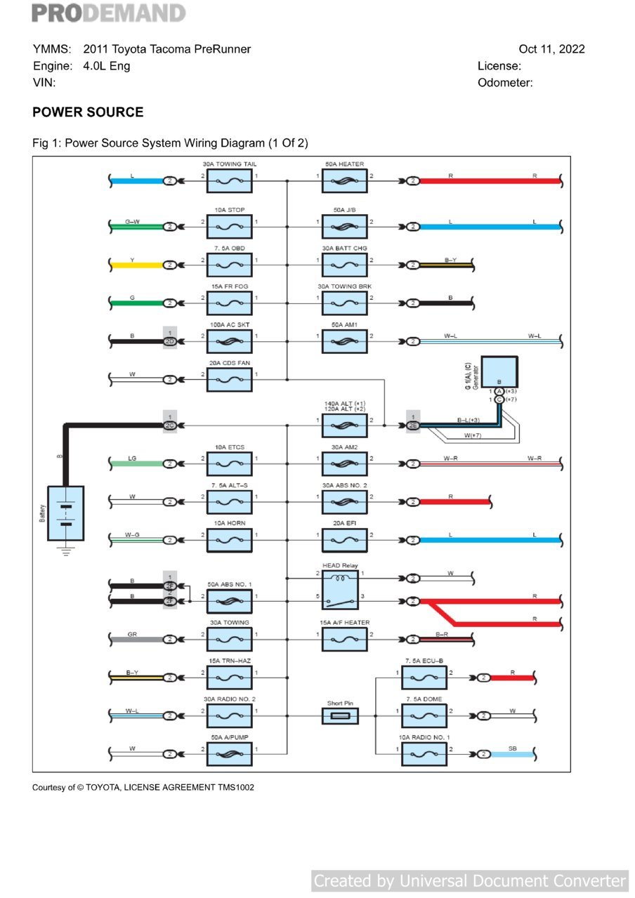

    Hello all! While putting in new AC compressor in my 2011Tacoma I dropped a wrench on the battery terminal. Made a big arc. Took battery out put new compressor in then put battery back in and now truck has no power. Totally dead. Bought the 120 fuse but really the old one doesnt appear to be burnt and it meters. What’s the next thing to go to? Thanks!!

    See which fuses are missing power, follow it back toward the battery, and you should easily find what's blown.

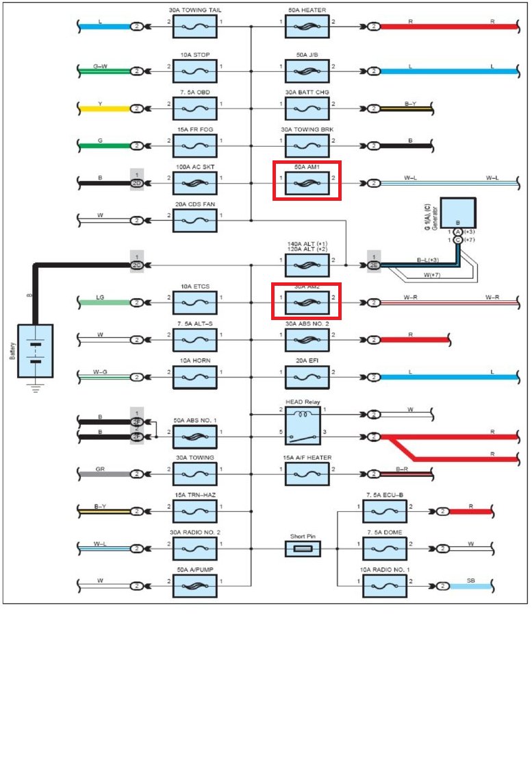

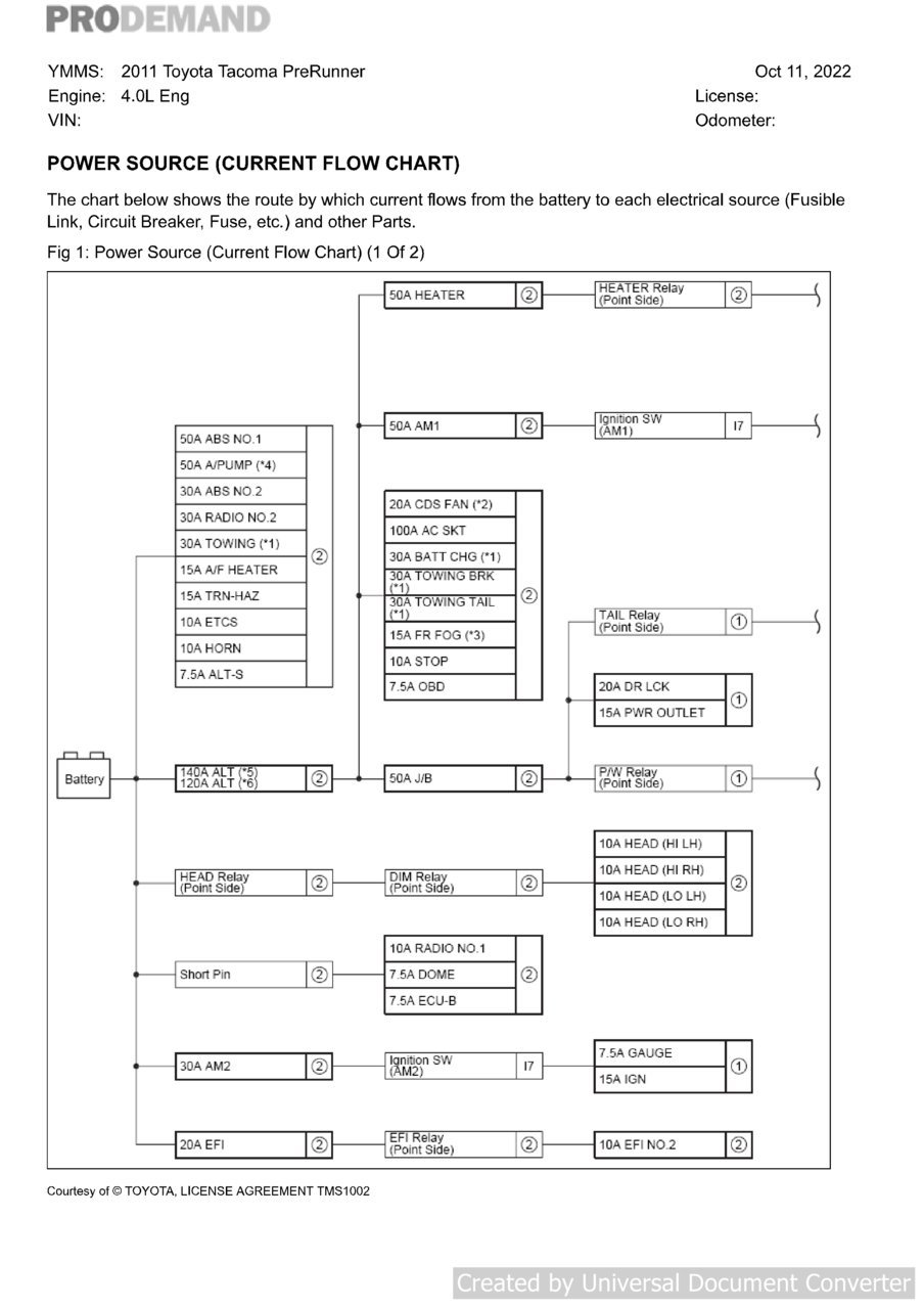

    Maybe these:
