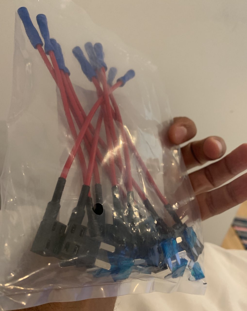

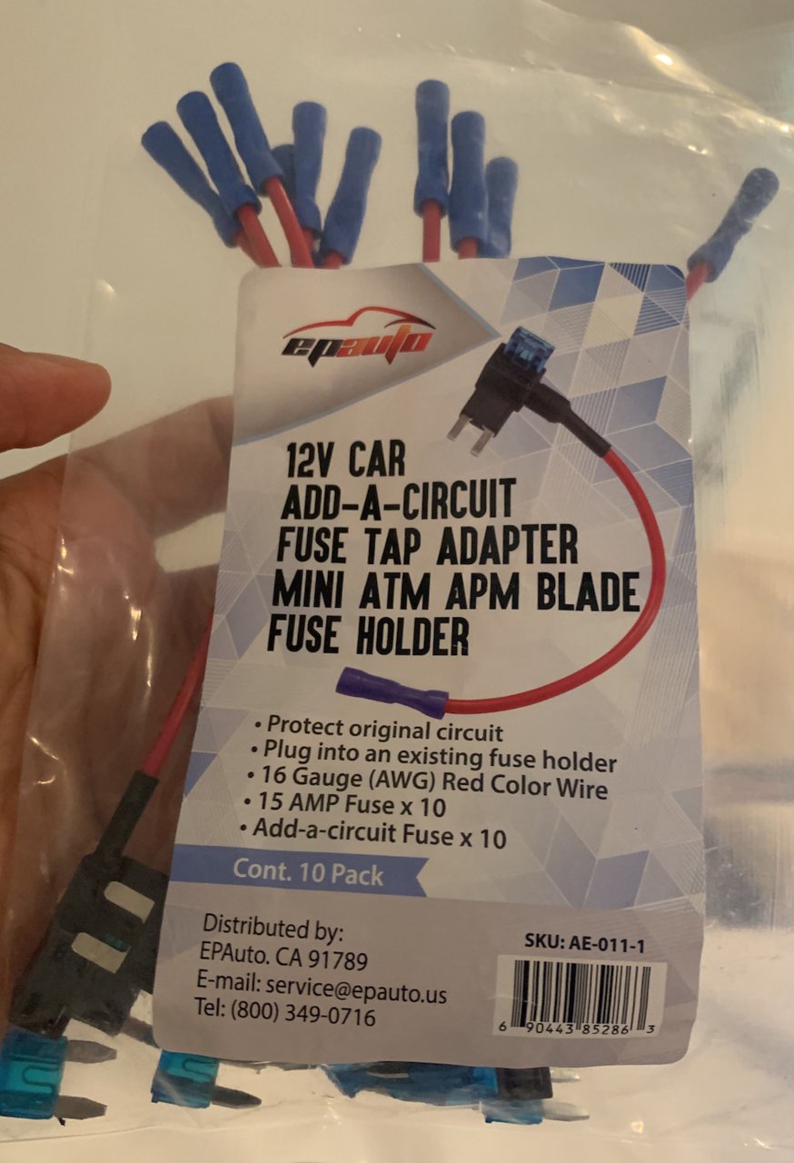

    Can i use these add a fuse for my tacoma?
    thanks

    I used these for the light bar in my truck

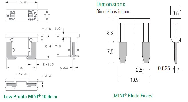

    Depends on where. I think under the hood is mini and under the dash is mini low profile.

    but will they work? the 3rd gen tacoma takes the low profile mini one. those metal things look long.

    They will "fit",but the correct ones are low profile mini's...

    They will fit and function. However, the fusebox lid under the dash doesn't have enough space underneath to accommodate the add-a-fuse. You can either run without the lid or get the roomier Meso Customs lid.

    I’m not 100% on which one I got, it does seem to be smaller than the ones you show here.
