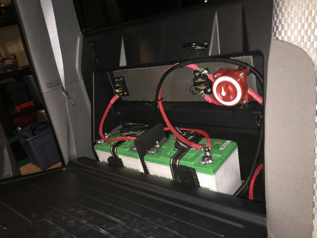

    How long is the run wire? If they are side by side or nearly so, don't worry about it. If there is a long run under the truck or somewhere the wires could get pinched or chafed then you should use a fuse or breaker.
    My aux batteries are behind the seat. I mounted the ACR under the hood and run 2 gauge wire under the truck (protected by braided sleeve and nylon split loom). Before the aux batteries, I used a blue sea battery switch and 150 amp breaker. The switch is wired as a breaker bypass for a high load if needed. Normally the switch is off and the current passes through the breaker. Howeve the switch can be turned on and the circuit breaker tripped to allow full current.
    However I don't have any circuit protection on the front end of the wiring and it makes me nervous. I'll likely be adding a breaker there and possible just making a short jumper wire to bypass if needed. Undecided.
