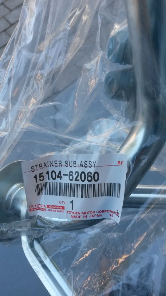

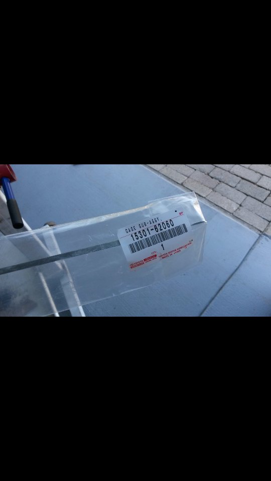

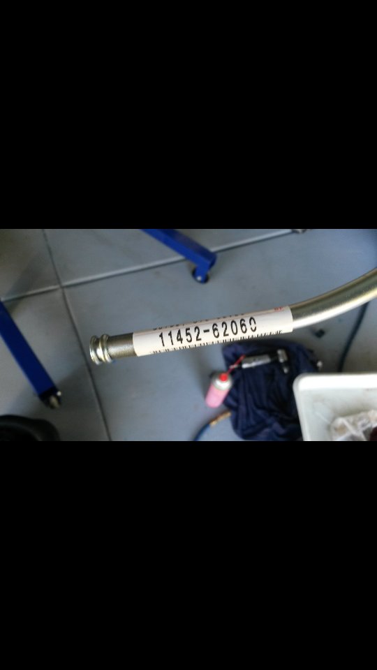

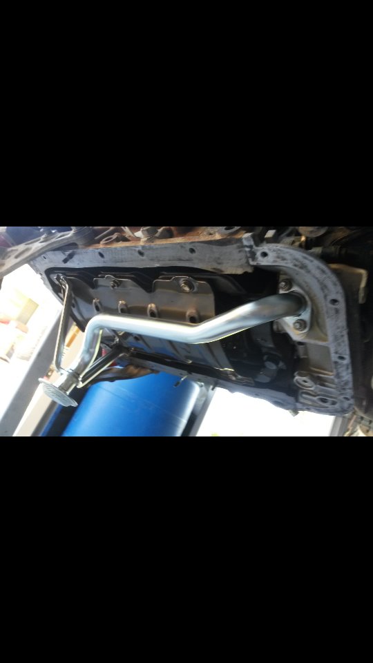

    If you pan swap, do it the right way and drill the side of your block with a jig for the oil dip stick instead of cutting your tacoma/4R dipstick to keep it in place. The TG kit is a complete kit but you must reuse the tacoma/T4: trimming the stick is your only option. You won't get an accurate oil reading that way and you'll end up pouring more oil then recommended.
    Cheapest route is to find a wrecked 4wd t100 and pull everything from it. Will probably cost 50 buck form junk yard. If not, I provided some pictures with oe part number to help your built. You'll need the union and o-ring as well. I can get you those part number if you need them.

    The pics are not all showing up. Do you have the pan part #? I thought the pan was a 2wd rear sump. Glad I didn't order it.

    I don't recall if I kept the part number for the pan but it's from a 4wd v6 3.4 t100. 95 to 98 4wd t100 are all the same.
