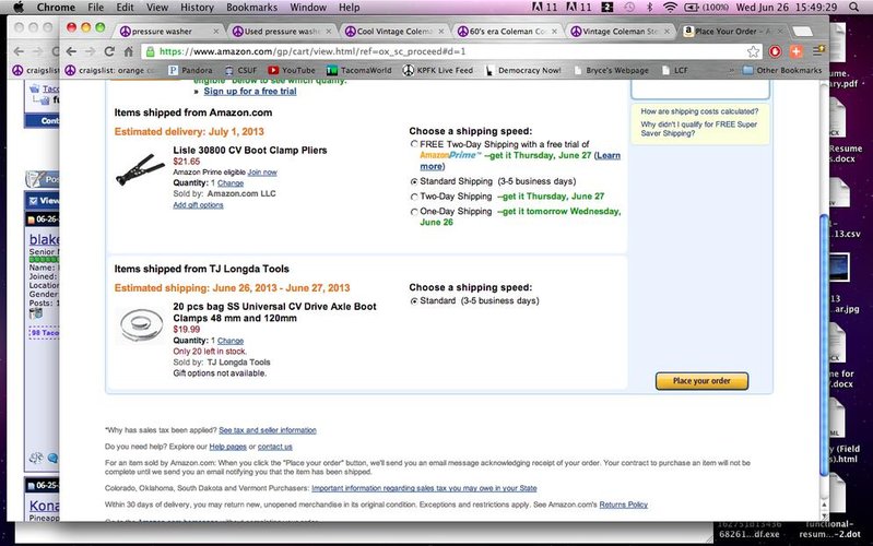

    Tool and clamps on Amazon:

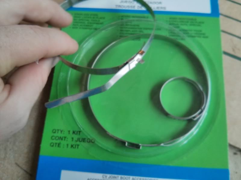

    Okay folks, I'll worry about my UCA's later. Right now, I need HALP! So, MY boots came with one type of clamp, and none of my parts stores have the tool in stock atm, so I decided to buy the "universal" clamps that work with my tool. Well, they're too small. Ugh. I see some have said use worm clamps. Is the is easiest way?
    The one im holding is what came with my boots. I don't have the tool for these type. . . The one in th package is the universal clamp I bought at the parts store, and they're too small. WAT DO?

  9. Jun 29, 2013 at 4:55 PM
    #49
    92LandCruiser
    92LandCruiser Well-Known Member
    Feb 20, 2010
    #31761
    8,324
    Nevada
    80 series Land Cruiser
    Cummins, tons, 40s
    Autozone has some ghetto clamps that are a different style and don't require specialty tools but I'd replace with real clamps down the line.

  11. Jun 29, 2013 at 5:53 PM
    #51
    MxRacer190
    MxRacer190 [OP] Well-Known Member
    Apr 15, 2010
    #35345
    2,489
    Georgia
    06 SR5 4x4 Indigo
    Where is the best place to buy worm clamps that will fit? I know Home depot has worm clamps, but idk if they have one that will fit the big end of the boot.
    I bought a tool today, but it's the wrong type. :(

  13. Jun 29, 2013 at 8:47 PM
    #53
    MxRacer190
    Apr 15, 2010
    #35345
    2,489
    Georgia
    06 SR5 4x4 Indigo
    I went to Home Depot and picked up a 4" and 2.5" worm clamp. They're not 3/8" but they'll do until I can get the right clamp tool. Everything went back on fine. Mission complete. It wasn't as bad as some make it out to be. The only thing that took time was going back and forth to the store to get a puller/clamp tool etc.
