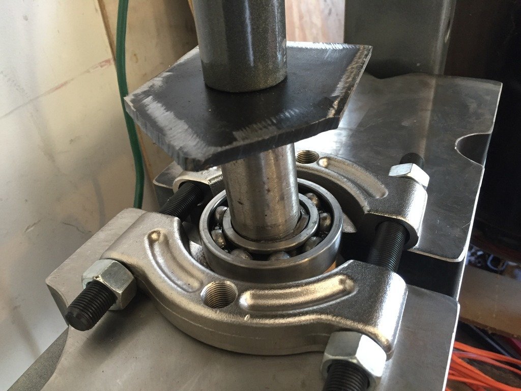

    90% of even seasoned press users position the 2 piece bearing press clamp on incorrecrly. It may seem trivial but it can exert unven pressure to item being pressed and over time will bend the bolts. This was pointed out to me once apon a time by a well respected machinist.
    Obsearve how the 2 piece press clamp (for lack of better wording) will have a bowing pressure applied to the unsupported bolts? Turning the 2 piece press clamp 1/4 turn will double the support and remove the bowing tension from the bolts
    FWIW

    Really appreciate learning information like this. The finer points.
    But I am at a loss to see any difference between the photos. The quarter turn does not present itself well. Have any other photos?

    So OP might have been using old photos for today's lesson and only spoke of the correct procedure, not demonstrating them. i get it now.

    The tool is called a bearing splitter not a 2 piece press clamp. I wonder if using on a press and resting on the level bed plates how any uneven pressure is exerted

    oops... did't mean to add the (wrongly positioned) picture twice.
    Sorry no (correctly positioned 90* turned) picture

    Yup, that read just prompted the FWIW
    Edit: Hey I am slow, just put 2 & 2 together. Not meaning to pick on anyone. I worked in a general repair/machine shop/ Shelby race restore shop as a newbie in the early 80's. Some of the smartest guys with stuff like this all day every day

    Thanks for the correct name :thumbsup:
    Uneven pressure on the race would be applied
