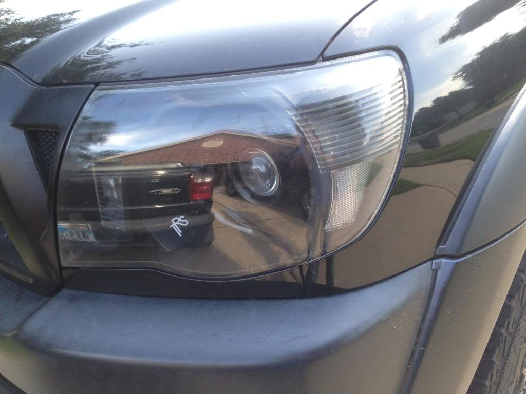

    This is mine with a 2.5" lens and gatling gun shrouds. I would say go 2.5" for the lenses because it just fits really well. The shrouds are really just personal preference. Just get a deep enough one to cover the entire projector because Tacoma headlights are pretty deep

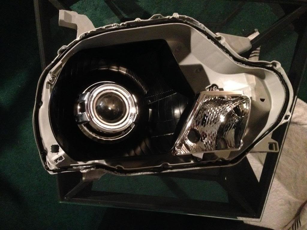

    This is where you still see the chrome ring around the projector
    4A33610D-E7D2-42C1-8AB3-786A5A65F7A6_zps_fc27a9fcd6afb17dfb723f9d4ec03e5fc9cb0a12.jpg
    I guess the bigger lens doesn't show this?
