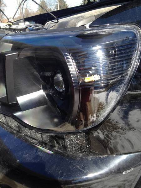

    Everything going smooth until

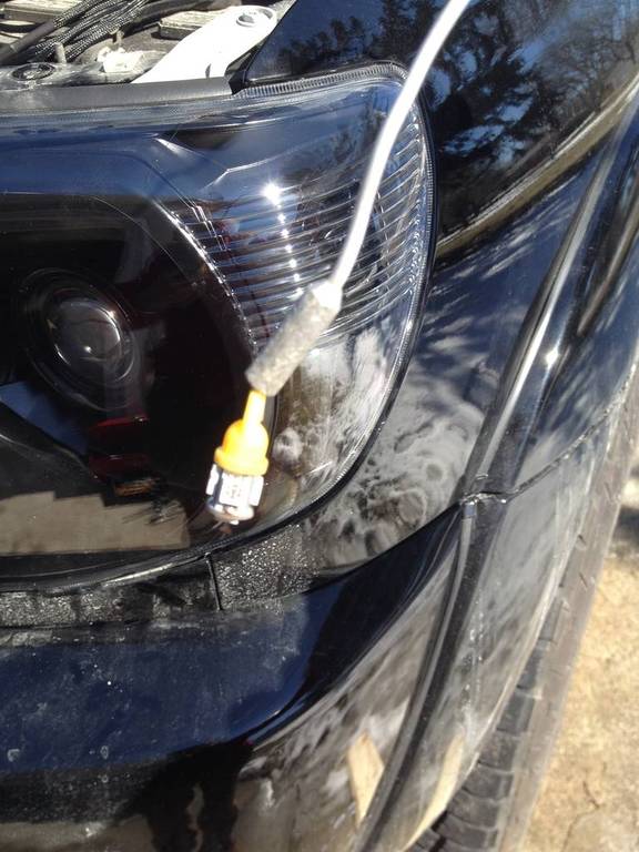

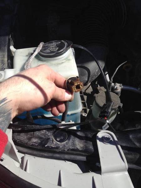

    Thats my 194 led bulb inside of housing. FUUUUUUUUUUCK
    I like to fish though, took ten minutes I considered myself lucky
    Dafuck do I do with this? Peter (A7xschecter6661) replied back in seconds. He loves this stuff you can tell

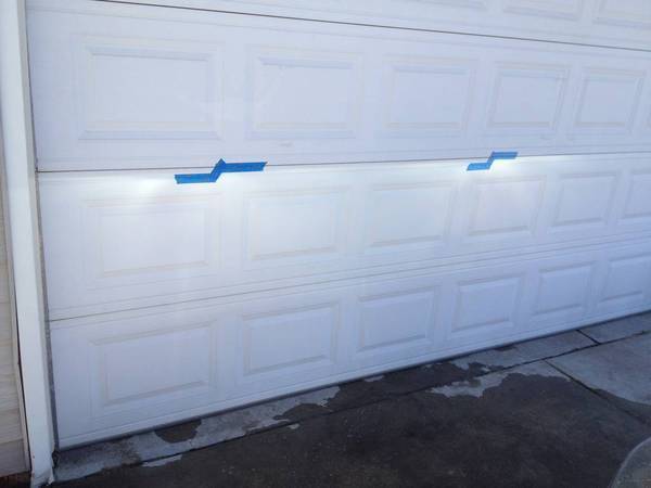

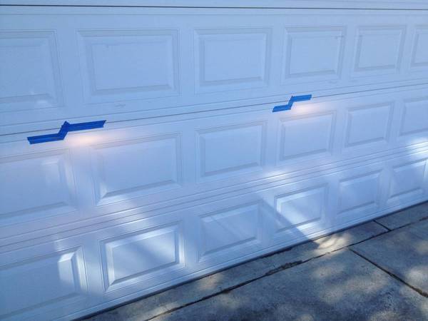

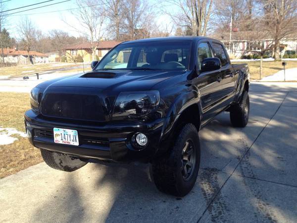

    Daytime sunny aiming attempt

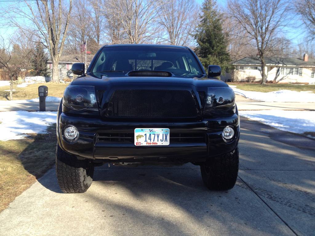

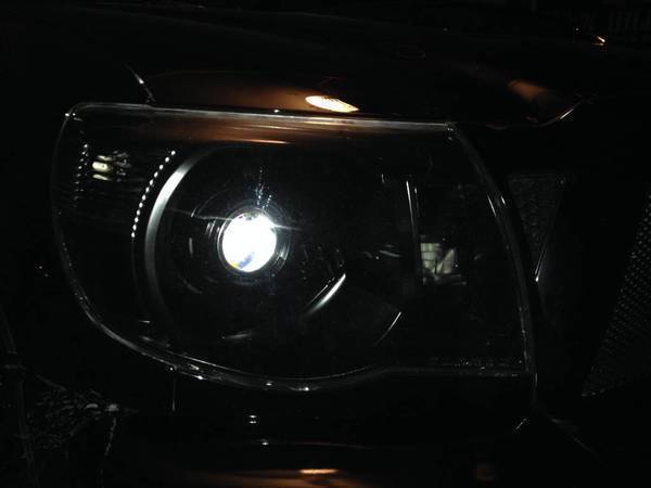

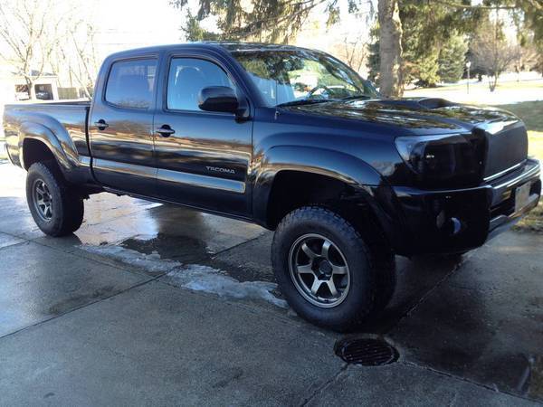

    Installed!
    Couldnt be happier!

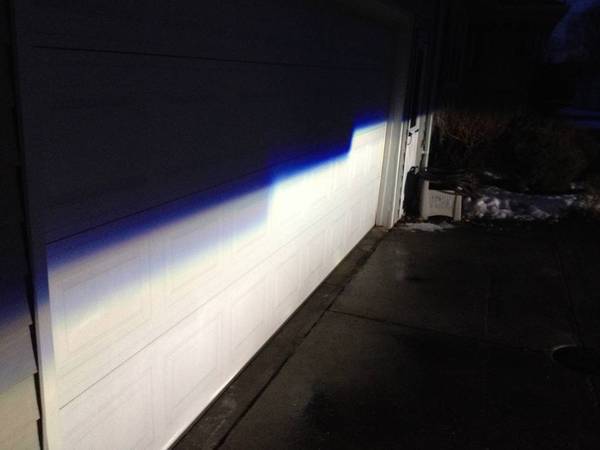

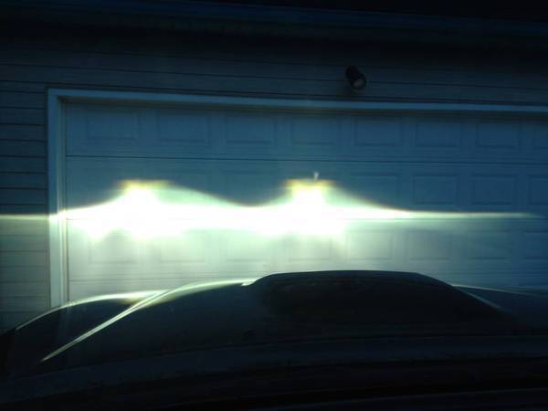

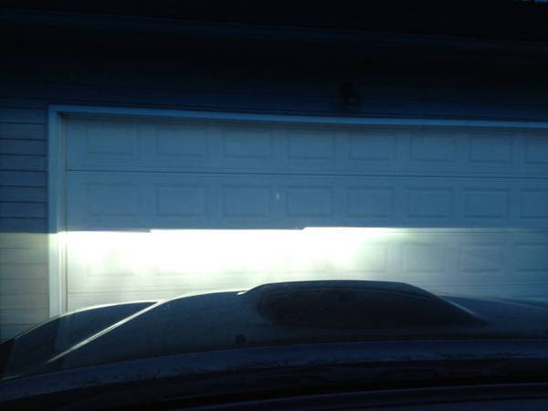

    Low Beam
    High Beam
    Gotta aim a bit better Peter to the rescue for Protips

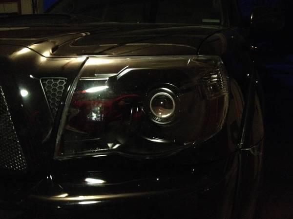

    Love the color

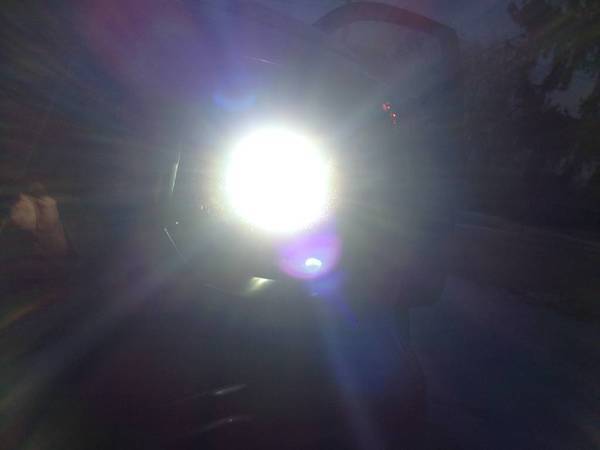

    It Burns!!!!!!!!!!!!!!!!

    Need to adjust the aim of the lights, but otherwise the work looks great. I don't have the balls to do an output marking during the day... :)

    Honestly it didn't really matter. I was shitting bricks until he sent me a picture of them level. We could see the projectors were level on the wall, so then it was just matching the height of the hot spot to the originals of the truck.
